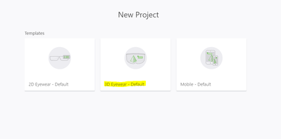

Hello Community,
By using PTC guide, I created 3D eyewear experience with a gesture project. In that, I have to do drag double tap from application event. But whenever I create project, then application event is not visible. What to do to get it visible. Here I attach file please check this.

Hello @NP_10149671 ,
Can you please share the project file and also a full screen screenshot of this ?
Also, are you experiencing this with every 3D-Eyewear Projects ?
BR,
Mohit
Hi @Mohit_Kabra27 ,
Here, I attach project file and screenshot. Please check with this.
Yes, I experiences this issue with every 3D-Eyewear projects.
Hi @NP_10149671 ,
As i can see from the screenshot, you have not selected the 3D-Eyewear template at the very first place and hence not able to see the application events option. You are currently using the Mobile template.
If you want to develop a 3D-Eyewear project ,you need to select the same template as shown in below image and then start building your experience.
Let me know if you still face any issue.
BR,
Mohit
Hi @Mohit_Kabra27 ,
I selected 3D eyewear template and build my experience. It's working.
