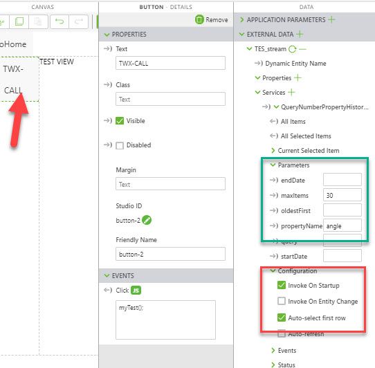

2.) You can call the data and filter it in the javaScript  loop / not so sufficient but for a simple case as in your example it could work fine:
//function which calls QueryNumberPropertyHistory
//with parameters
$scope.app.runMyTWXService = function() {
  var TWXmodelID = 'TES_stream';
  var serviceName = 'QueryNumberPropertyHistory';
  var parameters = {'propertyName': 'angle', 'maxItems': 30};
  twx.app.fn.triggerDataService(TWXmodelID, serviceName, parameters)
// myTest is called by UI button for testing see picture
$scope.myTest=function(){
$scope.app.runMyTWXService();
 $timeout(function()
  {console.log('retData')
   var retData=$scope.app.mdl['TES_stream'].svc['QueryNumberPropertyHistory'].data
   $scope.RESULT={}
  $scope.myFilter_min=50
   //any value to demonstrate a filter function here value should be > as min value
  var count=0;
  retData.forEach(function(value){
    console.log("value["+ (count++) +"]="+JSON.stringify(value))
    if(value['value'] > $scope.myFilter_min) $scope.RESULT=value;
//the first value which exceed the min filter
}) },600)

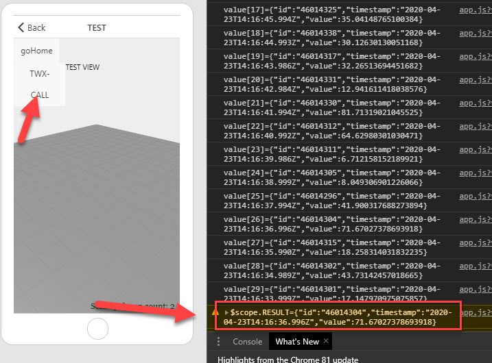

  $timeout(()=>{console.warn("$scope.RESULT="+JSON.stringify($scope.RESULT))},2000)
Then we can check e.g. the resutl in console:
For such static tables you can also pass the data as parameter in external data  and set the configuration to call it on statup - in this case you can call the service result directly :
