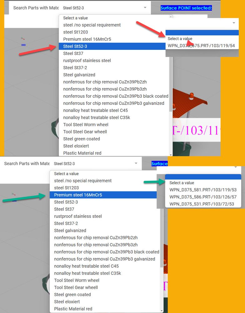

Here for example we use a value of one list and change the value of the second list. - so means we can generate a list dynamically and set it to the list property of the  select widget so that a new list is displayed.
Here in the example the value of one list is a filter for the second list. But you can use e.g. also a value of input widget that will also work
You can also add a new element to a list  etc.

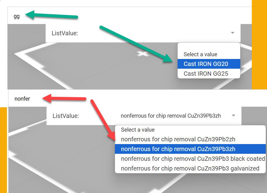

So possibly when you input a value /in input widget /then in the change event you will check the list  and filter it or find specific value and then set the the List and value property of the select widget issue- possibly  there is difference between the displayed name and the value .

  • so far I know we can not input the value directly. so when the select widget  is in focus then clicking a key will causes that it will the first displayed element in the list starting by that key. A second time click that will select the next element starting with that character.But that is the behavior in chrome browser - preview mode and this behavior is different on the mobile. You can not select any key when you do not have an UI for that - means you need to have an element what allows the keypad to be used on the mobile device therefore you need a input element in the 2D mashup or you need to call a popup which allow the filter.
then filter that in the input
  • regarding filter. So you can filter the where you change the ListProperty using some js code example
$scope.app.testListFilter=(theArray,filterKey)=>{
let retArr=[]
theArray.forEach(element => {
   if(~element.display.toLowerCase().indexOf(filterKey.toLowerCase())) retArr.push(element)
return retArr;
the first argument is the list and the second is the filter string locking into to mach display fields and it return the filtered list

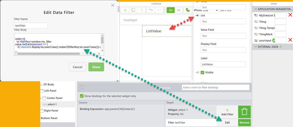

You can use also a filter to filter the data in the list from the binding  , but there  is difficult to use a $scope variable. Possibly somebody could help - how to use a $scope variable into the filter function. What will work is to use the window object e.g. window.myVar
where I used some code for the binding filter :
retArr=[]
let filterKey=window.my_filter
value.forEach(element => {
return retArr;
But here we need to do some action so that the list should "know" that filter changed and to update. When data changes that will update using the current setting of the variable my_filter ... but changing the my_filter windows variable itself will not update  the list automatically-because the binding  filter will not fire at this point.
