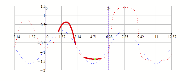

First task should be to make a plot (either by hand or via Mathcad) which shows that you are just looking for the minimum of the part of the curve plotted thick red. Fortunately this minimum (green dot) can be found easily using the zero of the first derivative ...

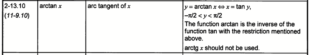

The name "arctg" is quite outdated and should no longer be used according to the current standard (ISO 80000-2)
In Mathcad this function is called "atan".

As already written - define the first derivative of the function, set it to zero and solve for x. The plot suggests that you have to look in the range from pi to 2*pi.
Fortunately the position you arrive at is within the intervals of interest. Otherwise you would have to examine the endpoints of the curve fragments of interest.
Give it a try! Set up a worksheet, define the function f, define its derivative and use the "root" function or a solve block with "find" to find the solution in the range (pi; 2 pi). Don't use the symbolic "solve" as it would not be able to find a solution.

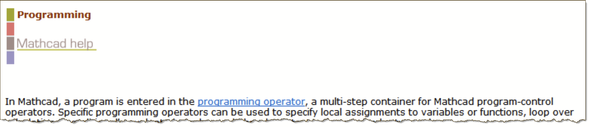

If you don't want to use Mathcads own numeric iteration methods but rather want to program it yourself, you sure have to look up and study the chapter on programming in the help.
You can't type the program statements in separate regions but rather you have to enter them in the so called "programming operator" as described in more detail in the help
Furthermore there is only a limited set of programming operators
Mathcads does not know an "else" (it uses "otherwise" instead) and there also is no "endwhile".
You can simply type in the programming operators but rather must pick them from the programming toolbar (Menu: View-Toolbars-Programming) or use the appropriate keyboard shortcut.
Its well worth studying this help section and also to follow the link to "Tutorial - Programming" at the end of that section.

Bit ignore the constraint that f(x) should be larger than the sine function given because in the plot it can be seen that this constraint is fulfilled anyway.
My root-approach looks for a solution in the range pi to 2 pi.
The program based on your attempt start with a guess value of pi and so also finds the desired solution.
