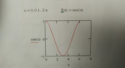

Function f(x)=cos(x)  x: 0,0.1..2pi
14 REPLIES 14
LucMeekes
(To:JF_10205473)
Please attach your Mathcad sheet, not just a picture.
slide_8.jpgdraw revolved surface using 3D plot. Idea of last out come shape of this. we have to get that shape in that cos(x) : x:= 0,0.1..2pi range. hope you can help.
(To:JF_10205473)
The 3D plot you show seems not to be from cosine.
Furthermore there are so many ways to rotate cos(x) for x from 0 to 2 pi - vertical axis, horizontal axis ...
Really appreciate all of your guy's help. Could you please help me to draw this attached shape, which is also shown 3rd shape?

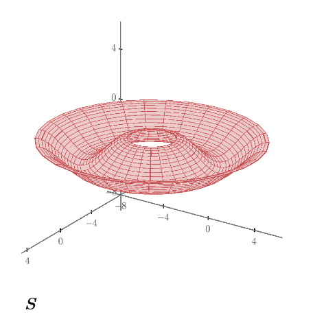

ttokoro
20-Turquoise
(To:JF_10205473)
(To:ttokoro)
I think its better to use the variables you introduced before when creating the mesh
I'd prefer a vector function over three separate ones, but that may be a matter of personal taste.
Its sad that Prime does not offer a way to quickly switch from the bad looking autoscale view
to a more meaningful "equal scale" view. In real Mathcad its just one click. Actually it can be done in Prime, but its a lot of manual work and fumbling around.
Its a pity that PTC is not willing/able to implement a 3D plot which is worth using and would offers at least the formatting abilities we were used from real Mathcad. This sure would still not be state of the art, but at least a huge step forward.

(To:JF_10205473)
Do you mean that the axis of rotation should be x=-pi ?
At least this is what the picture shows.
It looks to me like it's your homework. Therefore, I think it would be appropriate for you to show a little bit of your own work that goes beyond drawing the cosine function.
You sure will have learned something about how to mathematically represent a surface of revolution, right?
So start with your attempts in a worksheet and post it here if you run into problems.
ttokoro has shown a way how to do the rotation around the x-axis (y=0). You could now start to try to achieve the rotation around the y-axis (x=0) yourself. After that, we will go further and manage the rotation around a parallel to the y-axis, e.g. x=-pi, as shown in the picture.

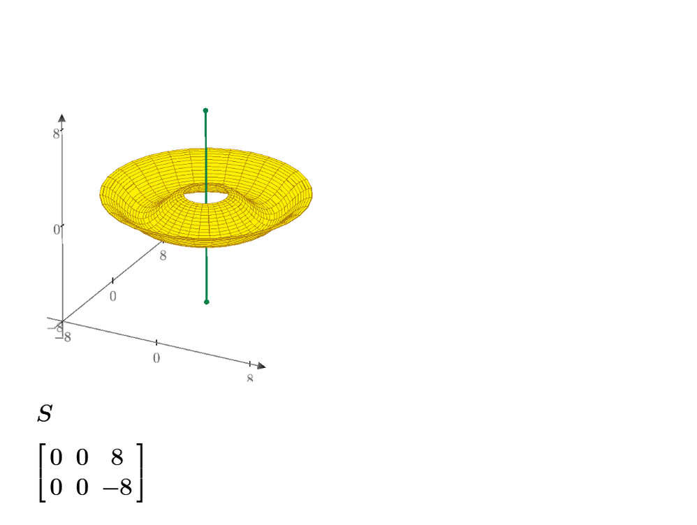

ttokoro
20-Turquoise
(To:JF_10205473)
Finally got the first one :  )  Could you please tell me how did you get the second one.
