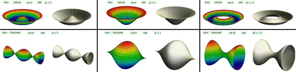

draw revolved surface using 3D plot. Idea of last out come shape of this. we have to get that shape in that cos(x) : x:= 0,0.1..2pi range. hope you can help.
The 3D plot you show seems not to be from cosine.
Furthermore there are so many ways to rotate cos(x) for x from 0 to 2 pi - vertical axis, horizontal axis ...
Really appreciate all of your guy's help. Could you please help me to draw this attached shape, which is also shown 3rd shape?

Really appreciate all of your guy's help. Could you please help me to draw this attached shape, which is also shown 3rd shape in our college
Do you mean that the axis of rotation should be x=-pi ?
At least this is what the picture shows.

This revolute function is so new to me in Mathcad. these are some samples I used to draw in Solidworks, since I saw it's possible to do this same plot in Mathcad I wanted to try that. In this task, I have drawn my base axis and the shape of the surface. how to make that revolves around that.

Finally got the first one : ) Could you please tell me how did you get the second one.
I don't know what the meaning of your "ew 11.mcdx" should be, but you should be aware that in your "tast ex1.mcdx" it is not a surface of revolution which is seen here! Its an elliptic paraboloid. It just looks like a surface of rotation because Prime automatically scales the axis that way and there is no option in Prime to automatically see the object as it really is (equal scale). You would have to manually edit the values for each of the three axis to get the correct view.
