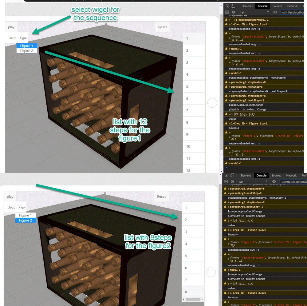

So I believe you want to have something like this /it is only test about the base principle

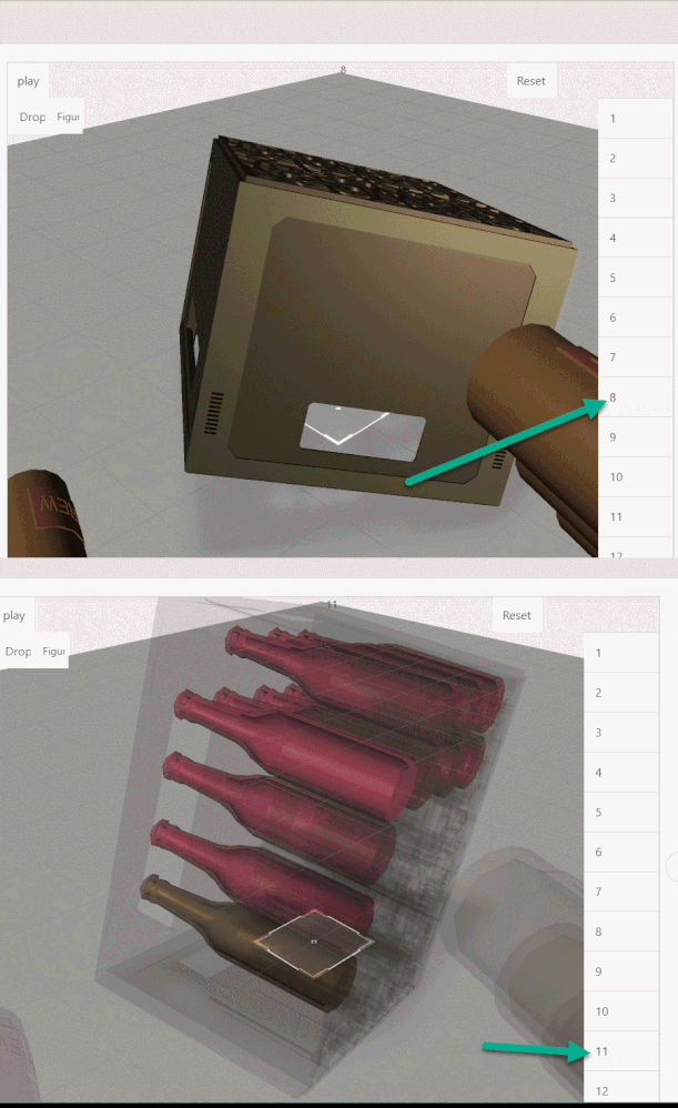

And when you click on the list with the step numbers, then  it should play the correct step / e.g. Figure 1 step 8 and later step 12:

So the code will load the json file and will set it to a js variable, here:  $scope.sequenceStepList

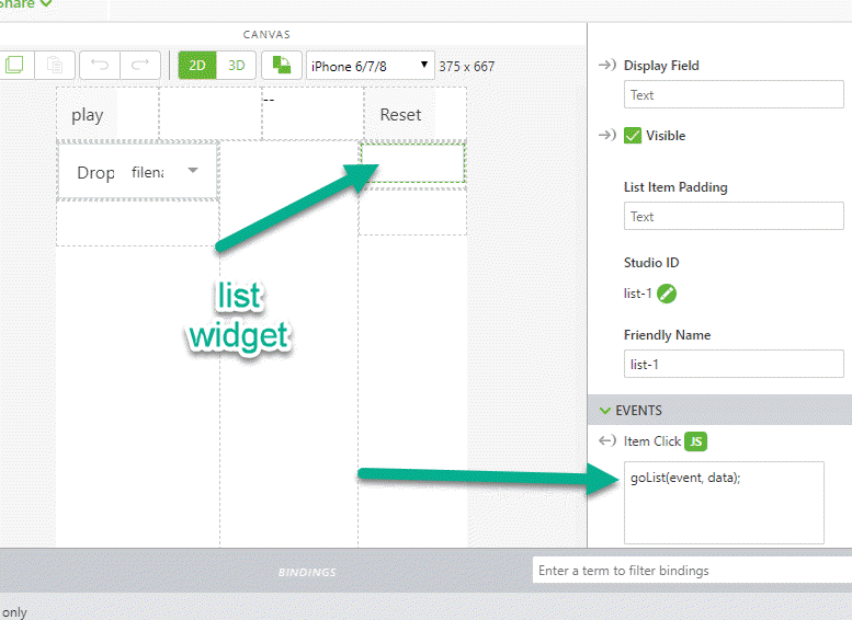

You can then create a binding between the sequenceList property of the model widget the select widget list property
in the next step    for the select widget you can define the following function to handle the change event (selectChange() )
$scope.selectChange= function () {
  console.log('$scope.app.selectChange')
  var found = findElement( $scope.sequenceStepList,'filename' ,$scope.view.wdg['select-1']['value']);
    $scope.view.wdg['list-1'].list=found.StepList
    $scope.view.wdg['list-1'].label="stepNumber"
This function(above) will now fill the list widget with the step for the selected Figure /sequence
Now (below)  we can define a function which should call the step number when we click the step in the list:
$scope.goList = function(event, data) {
 //set a parameter with the clicked step number - here not relevant
$scope.app.params.CURRENTSTEP = data.stepNumber;
console.log('stepNumber='+$scope.app.params.CURRENTSTEP)
 {setTimeout($scope.app.fn.triggerWidgetService(modelWdgName,"play"),500)},500);
  $scope.app.playModelStep($scope.view.wdg['select-1']['value'],modelWdgName,data.stepNumber,true)
