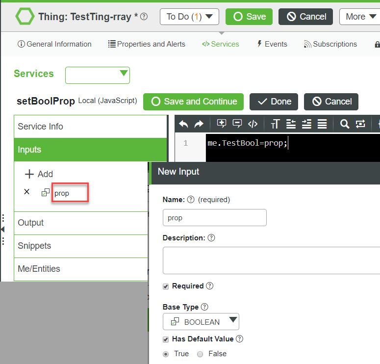

 Could anyone tell me how I can write a service with java? It is a simply bool value (true, false) and I found it, but it is not working:
$scope.app.mdl.Avtis_BudapestThing.svc.SetAnimation.data = 'true';
SetAnimation is the name of the service. If I use a button "click" action then it is working, but I want to write it automatically after some seconds with java.
Many Thanks
BJ
February 25, 2020
Hi @Janos1987 ,
I belive you meant js - code. If yes , then the js code should be some thing like this:
 twx.app.fn.triggerDataService('BudapestThing','SetAnimation',"{data:{\"prop\":true}}")
Where 'BudapestThing' is the name of the Thing which defines the service
'SetAnimation' is the service
and true is the value
here 'prop' is the name of the service argument  e.g. iin the definition of the service:
Here in the example below the code if we want to call the service according to the defintion shown in  the the picture above :
twx.app.fn.triggerDataService('TestTing-rray','setBoolProp',"{data:{\"prop\":true}}")
