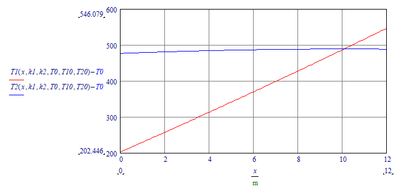

See attached worksheet.  This worksheet has been simplified down to the basic equations.  Currently I am required to iterate variables until the solution of both equations is equal at "L" (T1(L)=T2(L).  All variables could potentially be iterated to achieve the solution, but most common would be T1(0) or U1.

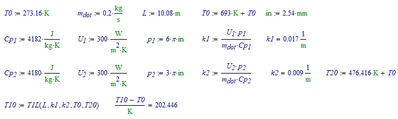

Answer: T1(0)=202.446 °C
Your problem:
Solve the set of ODE:
Extract the functions:
Check that it's the solution:
Solve the problem to find T10 for T1(L)=T2(L):
Fill in the numbers:
Plot:

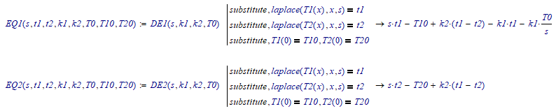

That is one way. As usual there are several ways (to Rome). So you can also do it the numeric way, by making the result of the solve-block a (set of) function(s) in T10, after which you can solve for the proper T10-value that makes T1(L)=T2(L).
You can also use the symbolics available in Prime 8 to compute the solution via the Laplace transform, which changes the set of ODE into a set of equations, which you solve and then transform back to the x-domain.
That goes like this:
Now with results
Note that in Prime the result may have the laplace integral (definition)
(  Something like LucMeekes_7-1758579389325.png   )
instead of "laplace(T1(x),x,s)" and "laplace(T2(x),x,s)" so you may have to change the substitution below for your needs.

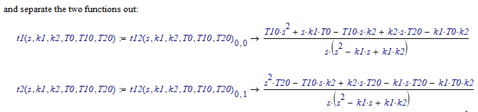

Simplify:
The functions may become big, but they should still be workable.
