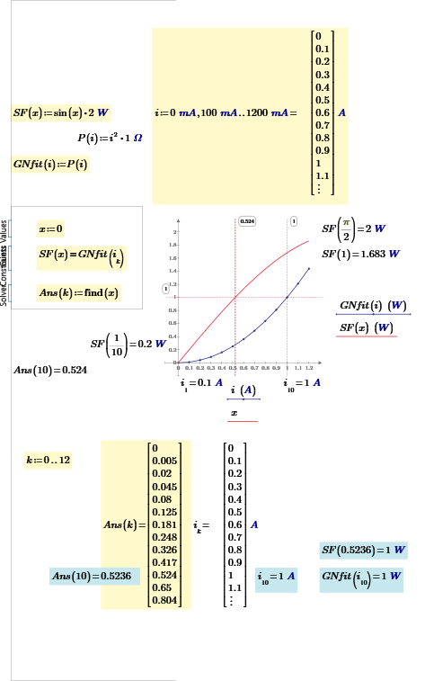

I am aware that this topic has been covered many times before, but I am a bit puzzled on how to achieve an iterated solve block in Mathcad Prime 4.0. I cannot attach my worksheet, unfortunately, but I will attach an image to illustrate what I am trying to do below.
I have one equation in terms of x, and one in terms of i. I want to find all the (x,i) points where the values of these functions are equal. The way I thought to do it was to somehow nest a solve block in a for loop.
I've seen previous posts that use the "Find" function, but I guess in prime, I can only use the "find" function inside a solve block.
The problem is that I'm looking for pretty good resolution in my data points. This is why in the attached image, i is a range variable going from 0 - 1200 mA. My end goal is to get a matrix of x values that correspond to those i values.

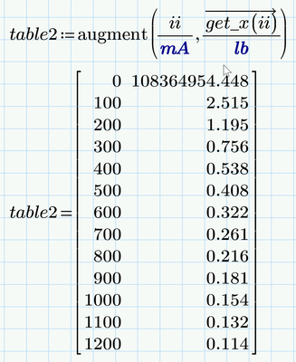

You may also use augment to create a matrix, but because the two columns use different dimensions/units, the units are displayed IN the matrix and unfortunately cannot be changed to something else - its the standard units only, so you can't
show mA
If a table is what you are looking for you might consider creating a table without unit by dividing each column by the unit you'd like the values to be in (just for fun I used lb for mass):

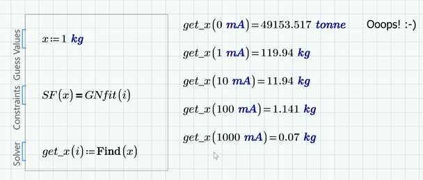

I defined some senseless functions here (the names of the formal arguments do not matter, I used x and y)
and the set up a solve block, turned into a function of i (again, the name could be anything)
As you can see in the pic above you now have a function get_x() which returns the x-value for every i-value you provide.
Use it as any other function you know.

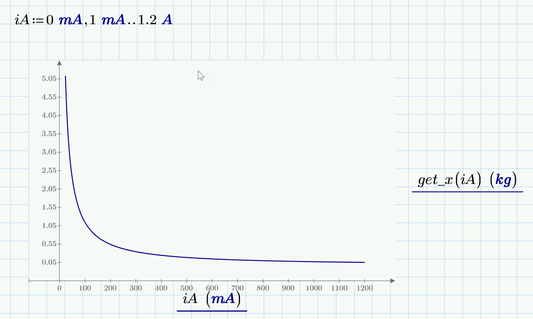

You can make a plot of x over i
Note that iA is a range variable only used for plotting.

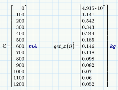

Now you can feed this vector as argument  in the function get_x() but you have to use the vectorization operator (the arrow over the expression).
You may assign this to another variable or just display it side by side to ii so you see which i results in which x.

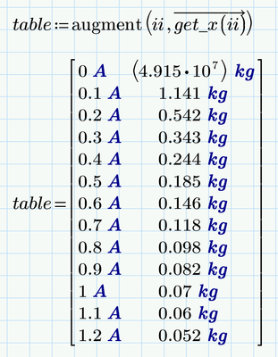

show mA

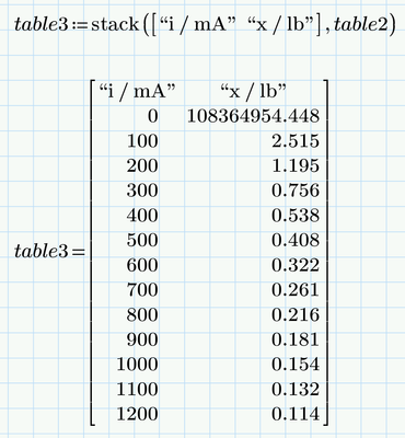

Feel free to add a descriptive header
