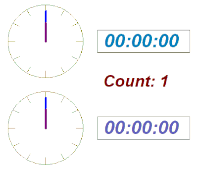

Anyway - challenge accepted. Lets use Mathcad 15 to simply watch and count (and stop before we reach 12:00):

Added the display of the times in the animation and attach the MC15 worksheet:

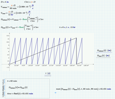

Simple problem;  simple answer:

@Fred_Kohlhepp
Maybe not that simple 😉
Your reply is missing the actual answer to "how often".
Furthermore only every second point of intersection is a valid solution!
12 of those 23 solutions are not valid!
E.g. the "solution" t = 12/13 hr = 55.385 min corresponds to 00:55:23.077.
At this time the handles do not pass but are mirrored by the vertical
The times we are looking for simply are all multiples of 12/11 hours.
really?
But you get credit for a really nice animation!
Yes, you showed a correct numerically arrived at solution for the time between one pass of the two hands and the next.
But the OP initially asked for "how often" (only now he changed it to "looking for the amount of time") and my reply mainly was triggered by what you wrote in the sheet/picture: "the question is merely when do they next intersect". And the very next point of intersection after 0:00 would be a wrong one and you skipped it deliberately without any further mentioning and hunted for the next which is a valid one 😉

I thought it'd be fun to think of it as distance travelled instead of angle.  Similar to Fred's otherwise.
