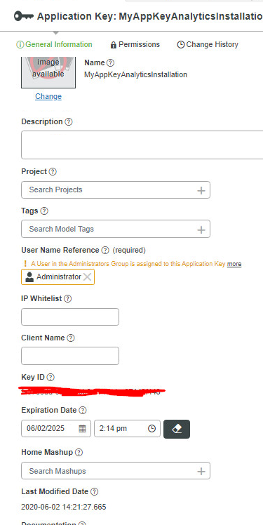

I created an appkey in ThingWorx Foundation.

Also note, the AppKey needs to be assigned to a user that has the ability created, read, write, and edit Things/Datashapes/Etc. Typically this is Administrator level access. A Restricted user cannot be used.
Details around this can be found here: Prerequisites – Windows Installation > ThingWorx Server

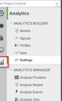

This may be irrelevant, but you have confused me. What is the difference between Platform Analytics and ThingWorx Analytics? You say I don't need ThingWorx Analytics to use Platform analytics, but I'm only aware of platform analytics, what is ThingWorx Analytics? Regardless of this sidebar, I will continue trying to install Platform analytics.As per here where it says I need to install Platform analytics to complete my pathway: https://developer.thingworx.com/en/resources/trial/analytics-trial-edition
When the documentation says ThingWorx server is a prerequisite for Platform analytics (e.g. here http://support.ptc.com/help/thingworx_hc/thingworx_analytics_8/index.html#page/analytics%2Fprerequisites_windows.html%23wwID0ENABS), what specifically is being referred to? It could be ThingWorx Foundation, ThingWorx Analytics Server, or Kepware Server. I believe it is the ThingWorx Foundation, please let me know if I am wrong.

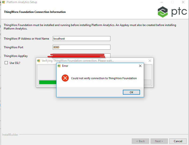

Using the AppKey here:
I have previously tried with a new user which I set to inherit Admin privileges (but this did not work either).

I think you would benefit from reading Knowledge Article around the ThingWorx Analytics Suite of offerings.
It appears that you desire to use both Platform Analytics and ThingWorx Analytics Server, the main Application is ThingWorx Analytics Server.
Analytics Workbench (the item in the sidebar you are referring to - Analytics Builder, Analytics Manager) is part of ThingWorx Analytics Extensions, for use with ThingWorx Analytics Server, and not with ThingWorx Platform Analytics.
The Tutorial you are trying to follow requires both, as far as I can tell in the description.
Also, is SSL in scope, I see port 8443 indicated in your connection info. Is this the correct port for you LocalHost Foundation (Platform) Server. Non-SSL deployments typically use port 8080 or 80 depending on your Tomcat configuration.
Note:
  • ThingWorx Foundation (Platform Server) is a pre-requisite for all ThingWorx Analytics Applications
  • ThingWorx Analytics Server - the main application for Data Analytics, Machine Learning, Predictive Analytics
  • Platform Analytics - ancillary offering, distinct and separate from ThingWorx Analytics main application, used for Property Transforms and Descriptive Analytics
Please read the article linked above for more details around the ThingWorx Analytics product offerings.

Since yesterday, I installed Kepware server for the heck of it. I got that installed and connected without issues. The connection used was 127.0.0.1 and port 8443 and the appkey I set up with Admin user (against best practice).
I have read the documentation you provided. It seems that I want to install the Thingworx Analytics Server (and enable the analytics extension during installation).
I have tried this morning with various combinations of 127.0.0.1 and local host, and port 8080, 8443, and 80. 8080 gets me the most promising error message:
As the documentation says[1], I need to have Thingworx server installed (as a prerequisite). I still am assuming that this is Thingworx Foundation (which runs a tomcat server).
Is it possible that this new error message is due to failed previous attempts (as per the first paragraph of this comment https://community.ptc.com/t5/ThingWorx-Developers/Thingworx-Trial-Installation-fails/m-p/578557/highlight/true#M31917)
[1] https://support.ptc.com/help/thingworx_hc/thingworx_analytics_8/index.html#page/analytics/analytics_install/thingworx_server_req_2.html#wwID0EU4BS

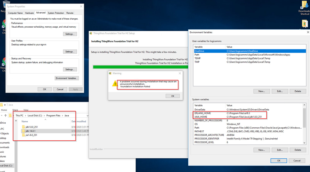

tl;dr: Thingworx isn't installing now, see current config for latest failed installation test.
Since your last reply, I have tried to change the port for the installation. I have done so by trying to attempt an uninstallation then reinstallation.
I uninstalled, and reinstalled with port 8000. That didn't allow any connection via localhost:8000/Thingworx/Composer/index.html
I uninstalled, reinstalled to try port 8079, installation failed. I tried port 80. install failed.
Since then, I have since been stuck in a loop of:
  • Failed installation.
  • Unable to reinstall due to Thingworx already installed.
  • Fail to uninstall due to Thingworx uninstaller doesn't exist.
  • Manually remove all registry entries for Thingworx.
  • Reinstall Thingworx
  • Installation fails.
Another sidebar, as this might help PTC 1) I discovered that the installer tries to create the uninstaller.exe at the end of the installation process. Maybe it should do this first incase of installer fail, leaving redundant files and no uninstaller being created. 2) the uninstaller doesn't seem to work consistently. 3) On a failed installation, I can see the uninstaller.exe in the ThingWorx folder, then after I click Close to exist the installer, there is a scrip that runs in a cmdprompt shell that deletes the uninstaller.exe. I say this because if you are an official rep for PTC, perhaps pass this on, as there is some issues here.
After a few cycles of manual uninstall/reinstall, I was unable to install even after manually removing the registry entries.
So I have created a new fresh Virtual machine, install all the updates, java, erlang, etc, set env variables, etc. And tried again.
Now with a fresh VM, the installation fails, and the loop above continues until the ability to install failed again.
I'm considering creating a windows 10 server VM (which would be best, I think? Keep in mind we're just testing this software), though, I did have Thingworx installed before on Win 10, so I know I don't need to do this.
At this stage I can't install Thingworx at all.

First of all, from the screenshot you provided, I see that you have JDK 14 installed.  I would recommend removing this as it could be causing some conflicts with the supported version.
Secondly, in regard to the o/s, you should refer to the installation requirements.  You mentioned downgrading to Windows 10, so I not sure which version you are currently running, but it sounds like it is not a supported version.
Please try these things and let us know if you still run into issues.
