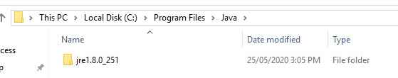

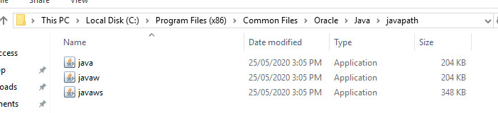

My version of java:
Location of Java:

The error messages displayed is the root cause. "Your JDK Directory could not be verified. Install the appropriate JDK version and launch the installer again."
The JAVA_HOME you have set is not a valid JAVA_HOME variable, as we are specifically looking for the JDK /bin location. You have the JRE deployed, which is not meeting the requirements for Platform Analytics.
Please install JAVA JDK, and point to the appropriate directory. Please note we are looking for the parent directory for \bin\java.exe
e.g. C:\Program Files\Java\jdk1.8.0_211
The path above contains the \bin\java.exe, if you please review my screenshot of my environment variables (when providing ERLANG_HOME example) in my previous post for how I have mine set.
You can find the prerequisites and installation instructions on our HelpCenter here: ThingWorx Analytics Windows Installation - Prerequisites – Windows Installation

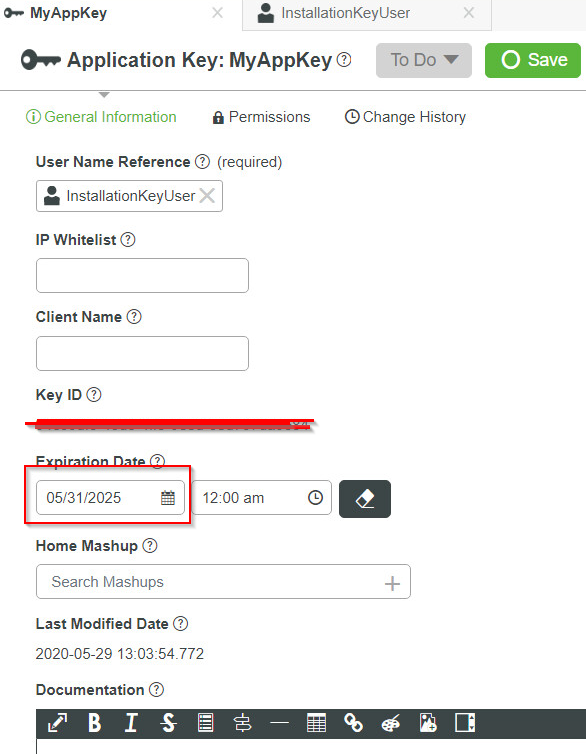

Also note, the AppKey needs to be assigned to a user that has the ability created, read, write, and edit Things/Datashapes/Etc. Typically this is Administrator level access. A Restricted user cannot be used.
Details around this can be found here: Prerequisites – Windows Installation > ThingWorx Server

Using the AppKey here:
I have previously tried with a new user which I set to inherit Admin privileges (but this did not work either).

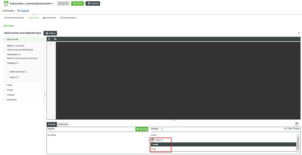

Can you go into Incognito Mode on your browser, and take a screenshot of your full URL when accessing ThingWorx Foundation (Platform Server)?
Can we also verify that you are indeed using a Trial License ThingWorx Foundation (Platform Server) ?
Please do the following: SYSTEM > Subsystems > LicensingSubsystem > GetCurrentLicenseModelType and provide a screenshot of what you see. That will provide the type of license you are using.
When I was asking about the commercial install, it was in regards to the source files being used. If ThingWorx Platform comes back with a Commercial / Enterprise License, you will not be able to use the Trial Edition of ThingWorx Analytics Server.

I now have this issue:
and with the bare url
