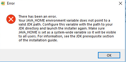

(I would simply install the server to check this possibility myself, but I encounter the following errors):
Server installation error:
My version of java:
Location of Java:
Environment variables:
Please note that having set the JAVA_HOME system variable (which wasn't set before -- although the same location was specified in System's PATH variable), I now get another error:
I've tired 127.0.0.1 and localhost.

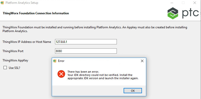

@Matt-H ,
I understand what you are attempting to do now. If you are only installing Platform Analytics, you do not need ThingWorx Analytics to use Platform Analytics.
The error messages displayed is the root cause. "Your JDK Directory could not be verified. Install the appropriate JDK version and launch the installer again."
The JAVA_HOME you have set is not a valid JAVA_HOME variable, as we are specifically looking for the JDK /bin location. You have the JRE deployed, which is not meeting the requirements for Platform Analytics.
Please install JAVA JDK, and point to the appropriate directory. Please note we are looking for the parent directory for \bin\java.exe
e.g. C:\Program Files\Java\jdk1.8.0_211
The path above contains the \bin\java.exe, if you please review my screenshot of my environment variables (when providing ERLANG_HOME example) in my previous post for how I have mine set.
You can find the prerequisites and installation instructions on our HelpCenter here: ThingWorx Analytics Windows Installation - Prerequisites – Windows Installation
Also note, the AppKey needs to be assigned to a user that has the ability created, read, write, and edit Things/Datashapes/Etc. Typically this is Administrator level access. A Restricted user cannot be used.
Details around this can be found here: Prerequisites – Windows Installation > ThingWorx Server
Neel

Thanks for your help. I installed JDK and got past my last error. But allow me to backup with my current high-level goal: As per this tutorial, I am trying to access the Analytics manager: https://developer.thingworx.com/en/resources/learning-paths/getting-started-on-thingworx-platform/analytics-builder-quickstart/analytics-builder-settings But I do not see this tab:
This is my view:
This may be irrelevant, but you have confused me. What is the difference between Platform Analytics and ThingWorx Analytics? You say I don't need ThingWorx Analytics to use Platform analytics, but I'm only aware of platform analytics, what is ThingWorx Analytics? Regardless of this sidebar, I will continue trying to install Platform analytics.As per here where it says I need to install Platform analytics to complete my pathway: https://developer.thingworx.com/en/resources/trial/analytics-trial-edition
When the documentation says ThingWorx server is a prerequisite for Platform analytics (e.g. here http://support.ptc.com/help/thingworx_hc/thingworx_analytics_8/index.html#page/analytics%2Fprerequisites_windows.html%23wwID0ENABS), what specifically is being referred to? It could be ThingWorx Foundation, ThingWorx Analytics Server, or Kepware Server. I believe it is the ThingWorx Foundation, please let me know if I am wrong.
Using the AppKey here:
I have previously tried with a new user which I set to inherit Admin privileges (but this did not work either).

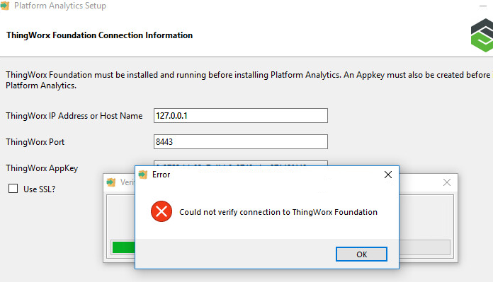

Matt-H
6-Contributor
(To:nsampat)
Morning (for me) Neel,
Since yesterday, I installed Kepware server for the heck of it. I got that installed and connected without issues. The connection used was 127.0.0.1 and port 8443 and the appkey I set up with Admin user (against best practice).
I have read the documentation you provided. It seems that I want to install the Thingworx Analytics Server (and enable the analytics extension during installation).
I have tried this morning with various combinations of 127.0.0.1 and local host, and port 8080, 8443, and 80. 8080 gets me the most promising error message:
As the documentation says[1], I need to have Thingworx server installed (as a prerequisite). I still am assuming that this is Thingworx Foundation (which runs a tomcat server).
Is it possible that this new error message is due to failed previous attempts (as per the first paragraph of this comment https://community.ptc.com/t5/ThingWorx-Developers/Thingworx-Trial-Installation-fails/m-p/578557/highlight/true#M31917)
[1] https://support.ptc.com/help/thingworx_hc/thingworx_analytics_8/index.html#page/analytics/analytics_install/thingworx_server_req_2.html#wwID0EU4BS

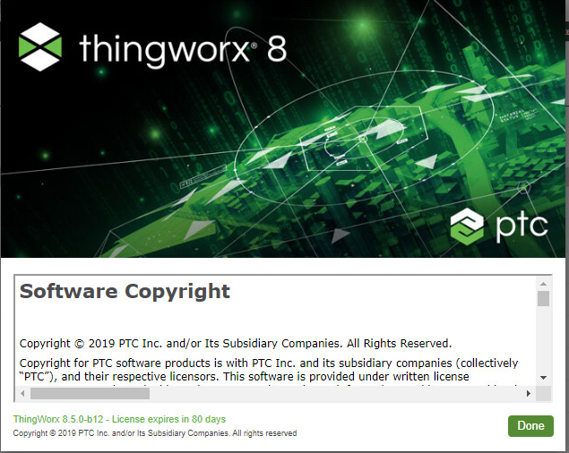

Can you go into Incognito Mode on your browser, and take a screenshot of your full URL when accessing ThingWorx Foundation (Platform Server)?
Can we also verify that you are indeed using a Trial License ThingWorx Foundation (Platform Server) ?
Please do the following: SYSTEM > Subsystems > LicensingSubsystem > GetCurrentLicenseModelType and provide a screenshot of what you see. That will provide the type of license you are using.

Matt-H
6-Contributor
(To:nsampat)
@nsampat
FYI

I'm fairly certain that port 8443 is reserved for SSL, and the Trial Edition of TWA will not work with SSL as its not in scope for the demo software.
Are you able to revert your Foundation Server (Platform Server) to port 80 or 8080?

I have Thingworx Foundation installed. I uninstalled Java 14 and waited for windows to not be running on 100% memory usage before running the installation. I also completed all windows updates and restarted.
Note, I am using Windows 10, not Windows server, which I have (until soon) been unable to get an installation of. With that said, I have had thingworx foundation running before (and I've completed many tutorials) on this Windows 10 image, so I know it is at least possible to get THingworx foundation set up on Win 10 (whether or not I run into issues later with other components).
I now have this issue:

and with the bare url

You indicated you had to wait for the memory to no longer be pegged at 100% before running the installer.  How much RAM do you have on the VM?  Sounds like it may be too low especially if you are running other apps.  But I'm glad you got ThingWorx installed.
For addressing the next issue, please provide the logs located at ....\ThingworxStorage\logs.  If you're not seeing any logs at this location, please provide the Tomcat logs located at ....\<tomcat_home>\logs.
The logs should provide a clue as to why you're not able to hit the url.
Regards.
--Sharon

The logs indicate ThingWorx is running.
Are you possibly trying to connect to ThingWorx on the wrong port?  You can validate the correct port by checking the server.xml file located in <tomcat_home>\conf?
Regards.
--Sharon
Matt-H
6-Contributor
(To:slangley)
Thanks @slangley I logged in today to try again and got in using localhost:8080/Thingworx/Composer/index.html
Though I haven't gotten Platform Analytics installed, I'll close this thread off here because we've resolved the problem of getting Thingworx installed (after uninstalling) has been resolved. When I want to try install Platform Analytics again, I will try and if I have any further issues I will create a new thread. This one has been a beast. Thanks to you and also @nsampat  for your help. Hopefully this thread is helpful to others.
