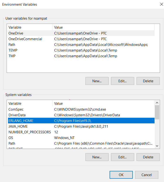

Analytics installation fails. Specifically, "ERLANG_HOME system environment variable is not set correctly. Set ERLANG_HOME to point to where Erlang software is located, for example, C:\Program Files\erl10.0"
I do have installed Erlang and set the environment variable for the system. The installation of Analytics still fails.

Also, please note, these variables must be set as a System Variable, not a User Variable.
Neel

I understand what you are attempting to do now. If you are only installing Platform Analytics, you do not need ThingWorx Analytics to use Platform Analytics.
The error messages displayed is the root cause. "Your JDK Directory could not be verified. Install the appropriate JDK version and launch the installer again."
The JAVA_HOME you have set is not a valid JAVA_HOME variable, as we are specifically looking for the JDK /bin location. You have the JRE deployed, which is not meeting the requirements for Platform Analytics.
Please install JAVA JDK, and point to the appropriate directory. Please note we are looking for the parent directory for \bin\java.exe
e.g. C:\Program Files\Java\jdk1.8.0_211
The path above contains the \bin\java.exe, if you please review my screenshot of my environment variables (when providing ERLANG_HOME example) in my previous post for how I have mine set.
