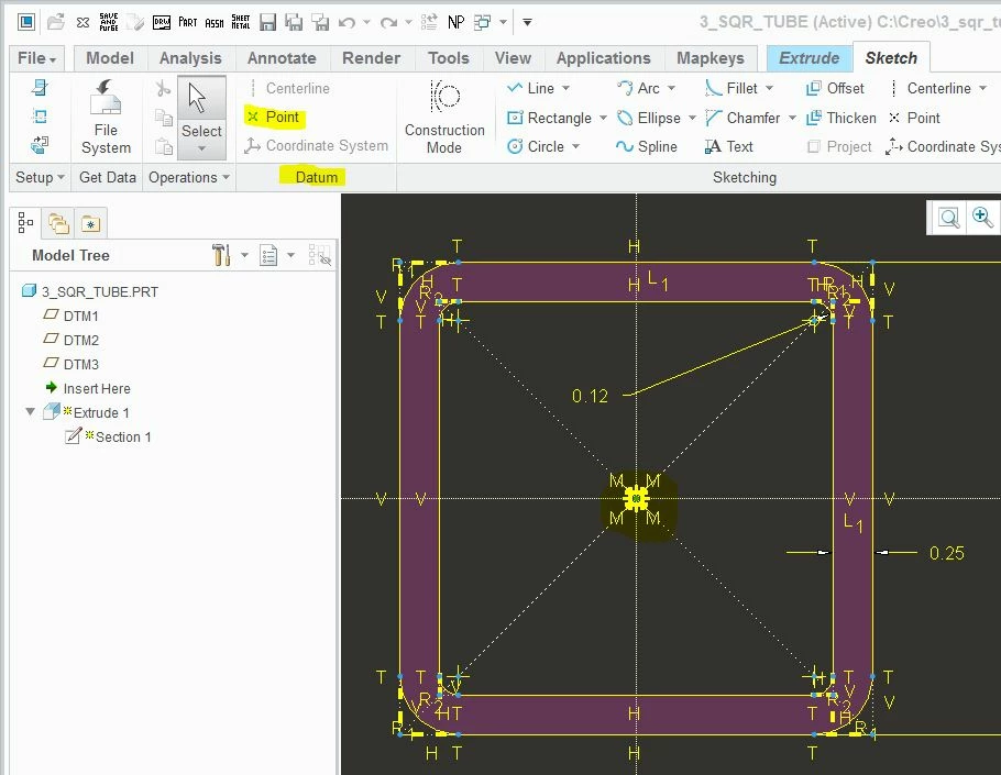

January 14, 2016
Your best option is to go back into the model and into the sketch for the feature and add a "Datum Point" in the center of the feature and that will create the "extruded" axis through the middle of the feature.
Hope this helps,
Shane V.

January 14, 2016
Are you adding the Datum Point inside of the Sketch for creating the feature?. Not as a feature on its own after the cut/extrude is created? If it is inside of the sketch feature it should "extrude" along with the cut/extrude feature. Does this make sense?

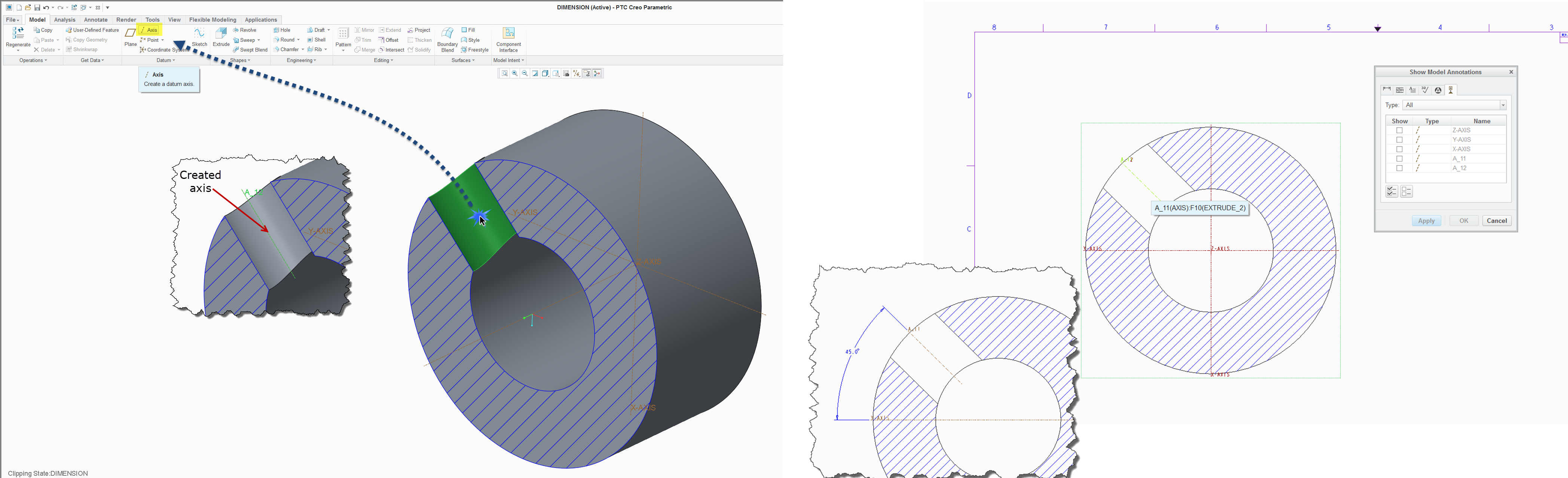

January 15, 2016
An option would be to create an axis on the existing hole and show that in your drawing for the desired dimension.  Donald, if you want to hit me with a PM, I'd be happy to create an online meeting and review options with you.    dimension.png
