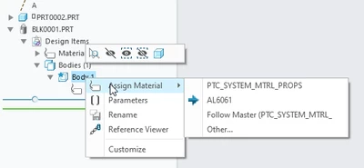

Apr 1, 2025 10:03 PM UTC
Add the bulk item to an assembly, expand it out until you see the body of the bulk item, right click on the body and Assign Material.
Edit:  Just realized you said Creo 2.0.  Not sure if this would be supported.

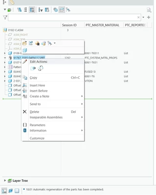

Mar 16, 2026 10:10 PM UTC
This indeed is not a feature of Creo 2.0. However, I'm now working in Creo 11.0.6 and still do not see the option to expand bulk items out, right-click, and assign materials. By right-clicking it within the model tree, I have options to move, suppress, replace, open, etc., though no options to expand and right-click bodies for assigning materials. Opening a bulk material leads me to its relations/parameters window where I still can't update the material.
Mar 17, 2026 1:25 PM UTC
If that is a bulk part that was created in 2.0, maybe try creating a new bulk item and see if the option becomes available.
