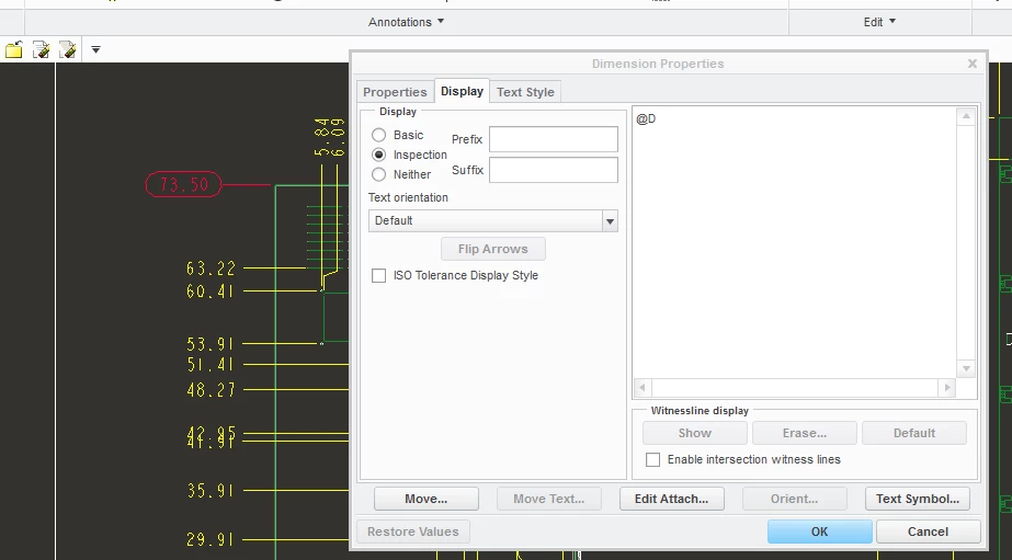

April 24, 2014
You could just check the inspection button in the dimension properties. Any text you add will be included in the "racetrack".
[cid:image001.png@01CF5FA0.56AA2130]

April 24, 2014
This worked. For some reason I kept using @[ to try to close it, duh!
