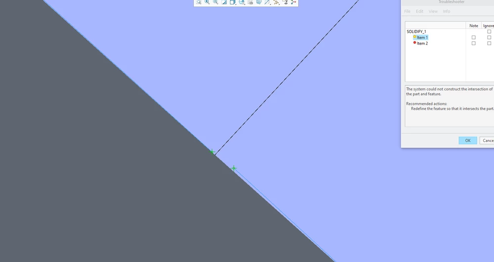

I've got a huge problem with solidify operation in Creo Parametric 7.0. In general I have the solid body (usual rectangle made by Extrude) on which there's a varius-shaped surface that was created by copying geometry from the STEP file. When I'm trying to trim protruding parts of extrude by solidifying (with remove material option enabled) I've got the following error
Please note that the green vertexes are not joined and there's a little bit place between them (the picture above has been zommed in much enough inside Creo in order to show this situation). These vertexes make my part unable to solidify which is visible in the picture. I tried to fix the STEP in Data Doctor. The Geometry Check option (in import DataDoctor tab) doesn't show any bad stuff on and in proximity of my copied surface. Therefore I've no idea why cannot perform the operation. Do you have any suggestions? Of course I'll provide more information about this problem if necessary.
Thanks in advance for all replies!

Can't see well enough to tell what's going on.  BUT, you might need to tweak your Absolute Accuracy (don't use Relative Accuracy).  Also, try extending the edges of the surface to make sure they protrude out from the solid.  maybe even as little as .010 will do.
Best of luck!

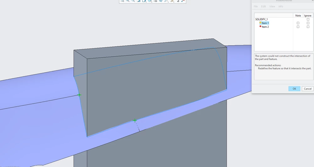

Thank you for your reply! Yes, i forgot to write that all edges protude from the solid out. Please look at the picture below
Now you can see that the surface is bigger than the solid and the egdes are actually out. You can also see the vertexes on the front and left side of the solid rectangle (in the picture I'm still inside Solidify). I tried to find some gaps inside the STEP by using Find (Tools > Find) option but even in 0.0001 scale there's no gaps. This purple surface which you can see in the picture above is a little part copied from the STEP. A I mentioned earlier - IDD wasn't show any imperfections on this part. This looks like an internal error of Solidify operation.

Something's wrong with the surface then.  I'd delete it, change the part absolute accuracy to .0001", then if I remember there is an option for importing where you can use the accuracy of the the part you're importing into, and try that.  If that doesn't work, you may have to recreate that surface internally with a boundary blend.

Post the STEP file so that it can be queried in detail inside Creo. I suspect that the purple surface is not a closed quilt but I can not tell without looking at the data set in Creo.

Well, it looks like an open quilt, but that doesn't appear to be the issue since quilts don't need to be close to use to cut solids.  It looks like either the quilt has a tiny sliver opening in it or actually collapses onto itself and that's the problem.
