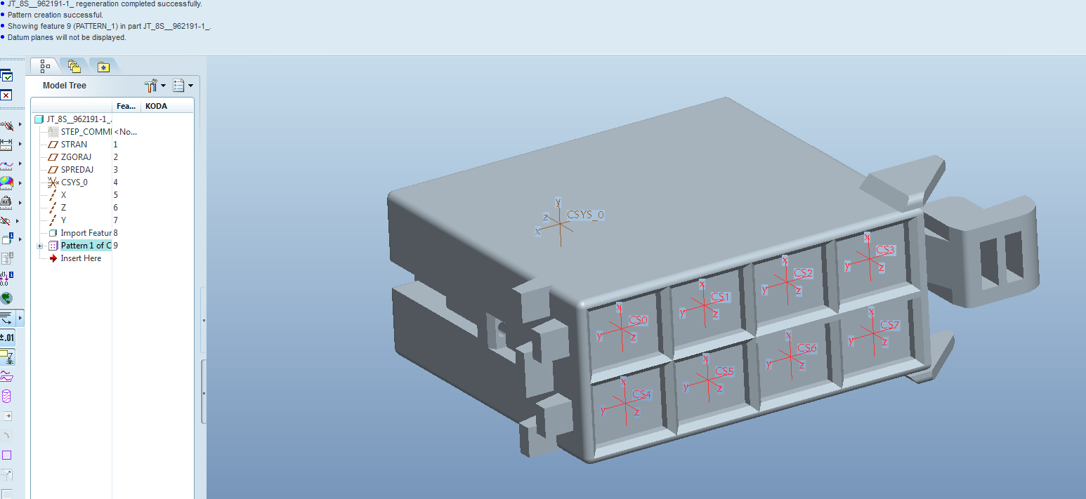

I would like to know how to change default naming of coodinate systems in ProEngineer 5, so instead of CS# (where # means a sequential number of created coordinate system - you see this on the picture) I can create for example P1 and then I use Pattern to create coordinate systems from P2 to P24. As you see in the picture I need to edit connector with entry ports and I would like to name the male connector's entry ports like P# and female connector's entry ports S#. This would save me a lot of time with editing my database of connectors and manual renaming every coordinate system (entry port).

Out of the box your requirement is not supported in the current software. I believe you could create a small toolkit app that would provide and efficient method of re-naming the csys to a pre-defined format.
