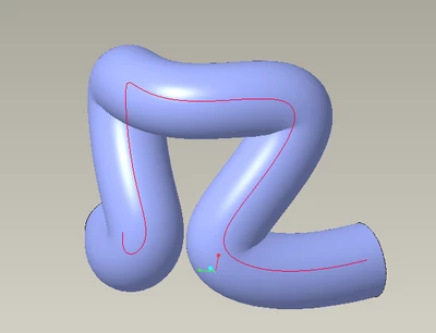

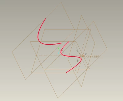

Here is a quick sample model (Creo 7) of how to use two planar curves to generate a 3D curve. If you can sketch on two planes to create the route this will work and is quite robust. You do need to insure that the curves actually intersect when you do this. If you need a visual cue when working then just extrude a surface from one or both curves.
Create two planar curves that represent the routing path projected onto a plane. I used splines for each planar sketch in this example. They do not have to be splines but the intersection of the curves should maintain G1 (tangency) or higher continuity to be a robust sweep trajectory.
Intersect the curves to generate the sweep trajectory 3D curve

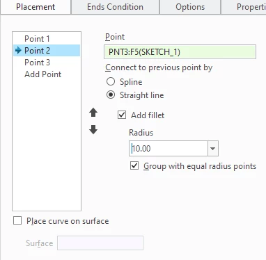

For "soft" routings I generally use a spline through points.  That would be for hose, wire, cable, etc.
For more controlled "hard" routings I use one of two methods.  That would be for rod, pipe, metal tubing, etc.
  1. Intersecting 2 sketches
  2. Curve through points with straight lines and added fillets.
  3. I have also seen sketching sections with end curves on planes as needed.

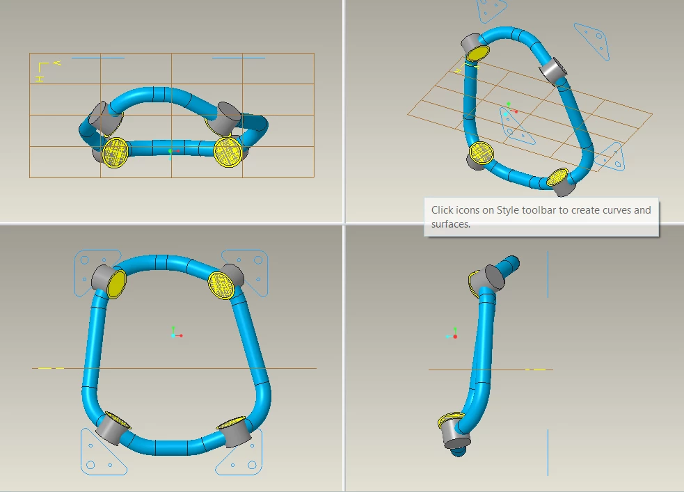

tbraxton
Jul 29, 2022 8:18 PM UTC
This illustrates 3D tube routing using the method (intersection of curves) mentioned by @kdirth above. All of these tubes are CNC bent and laser cut to join the cylindrical connectors. It works quite well for 3D routing problems but can be tedious. All of the 3D routes seen here were created by intersecting two planar curves to create a 3D curve. A skeleton model is used to manage constraints such as min bend radius on the tubing so the sweep trajectories are on the center line of the tubing which makes programming the CNC bender faster. It looks quite rudimentary but is not trivial to model with all of  the constraints.

In the diagram shown I see 4 sketches but do not see how that generated your complex curve and or points?
