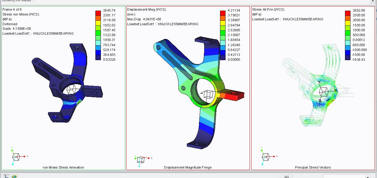

anybody know how to get factor of safety of part after analysis ??
here , I want to get fos of part.

Factor of safety is defined as FS = allowable value / actual value
So in your example, suppose the allowed deformation is 8mm, then your FS on deformation = 8 / 4.2 = 1.9
For stress, the material's yield stress is usually used as allowable (FS on plastic deformation) or sometimes the material's ultimate stress (FS on failure).
Or if your part is loaded repeatedly, you might want to calculate the FS on fatigue. This can get complicated, but for steel a good first estimate is to use the materials fatigue strength as allowable. (Fatigue strength is the maximum stress that the material can endure indefinately, so the asymptote in the S-N-curve).

Thanx, but we needed FS at everypoint of component in analysis for our project.
February 1, 2016
If the analysis is linear, just apply a scaling factor of (1/allowable value) in the results window (you might need to have more than one load set to enable this option).
It will give you exactly the same plot, just with the numbers scaled... (I'm not sure quite what additional information this will provide).

Hello Jainam,
On the simulation of your parts I see that constraints are very high.
I'm wrong can be.
I do not know what is the material on the basis of its forms?
Kind regards.
Denis.

in this part may force value change.
but with the help of FOS. I want to optimise my part.
