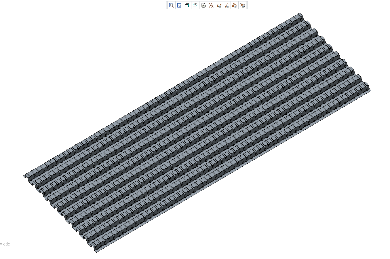

I have created the geometry that I need for a model but need to pattern it 10 by 62.
For some reason Creo will not successfully pattern it no matter what I try.
I have  tried patterning it in smaller chunks like 10 by 3 and tried rearranging the features but it still will not work.
Any ideas on how to resolve this would be greatly appreciated.
I have attached the model for anyone who wishes to try and resolve the problem to use.
thanks,
Jed

Hi Jed,
don't think you can pattern a shell, insert above it and it will work in the front direction.
the right direction failed something to do with the rounds.
With that said, I refrained from clicking on the green check-mark.
I drive a rocket and it would still be very painful to watch 6200+ features regenerate.
And adding the shell on the back end will be a beast, that's a lot of surfaces to click on.
is the finish deal 620 separate parts?
do they bang into each other making a single part?
not knowing the answer to the question above, the attached model is what I would call
"no time, just make it work"
to keep the file size down some features were suppress and you have to resume them.
good luck

Hey, yeah I have been having issues with the rounds in particular and yes they intersect and form one solid sheet. the spacing is 40 and 100 respectively.
The file you sent appears to be coping much better with the patterns. I have edited the pattern spacing and so far it appears to be working up to a pattern of 10x20 but any larger and it appears to be struggling.
Thanks for the help though, it is a definite improvement

I suggest you to use Geometry Pattern. See uploaded data created in CR2 M070.
  • I created new block.asm
  • I assembled your block.prt
  • I made a copy of block.prt, named it block2.prt and removed all but first 4 features from it
  • I assembled block2.prt
  • I copied boundary surfaces of block.prt's geometry into block2.prt
  • I solidified surface geometry in block2.prt
  • I created Directional pattern of surface quilt in block2.prt
  • I created reference pattern of Solidify feature in block2.prt
MH

Thanks for the advice, I had also tried geometry patterns. By Geometry patterning in sets of 2 repeatedly I was able to double each time up to a pattern of 32 rows which is much closer than I had previously reached.
I will keep working at it and try out your suggestions.

I tested component patterning in the assembly. 40x100 pattern can be created in couple of seconds.
MH

Hi Jed, try this
create a new assembly
assembly your block model as is
create and assemble a new part
in the assembly, active the new part
copy&paste the solid surfaces of the block model and solidify
group the copy and the solidify
pattern the group
I went for 10x62 in my test assembly/part, it worked...but...1866 features....very nasty lots of white and not responding
the upside is it worked.
10x31 was smooth under a minute to regenerate and a copy solid surfaces, move copy and solidify to make 62 works good.
I would have attached the model but it got a bit on the large side
good luck

I looked at it a couple times, and I'm not sure if the stacked groups is helping or hurting. I started to model it as one part, with the base one feature (size of the pattern), make the large part the full length, and pattern it one direction, etc. But I gave up, even that was taking some time.

You can try this method but it stills takes some minutes to regenerate and you will get a 275 MB file:
1 - Copy all the surfaces.
Select one surface, RMB, Solid sufaces, copy, paste ok.
2 - Pattern the quilt.
Select the quilt, do a pattern in two directions, and select "Identical" on Options tab, ok.
3 - Get rid of the solid.
Do a extrude cutting out the solid geometry (not the patterned quilts).
4 - Solidify and pattern.
Select the first instance of the previous pattern and select "solidify", then "pattern" (by reference).
Take a cup of coffee now.
Hide the surfaces and it's done.
Something similar to this:
http://www.e-cognition.net/pages/TurboPattern.html
Jose

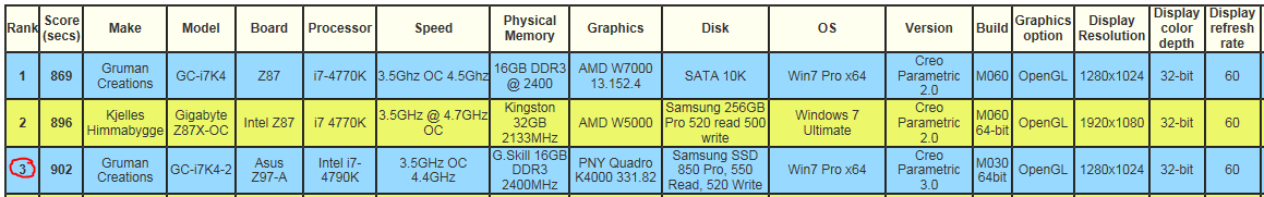

Tom,
please can you publish HW configuration of your PC ?
MH
September 22, 2015
It's a Gruman Creations GC-i7K4.  Currently number three on the Ocus Benchmark site:
Mine is actually a little older.  The new ones we're buying now are the GCi7K4-2 (AIR).
