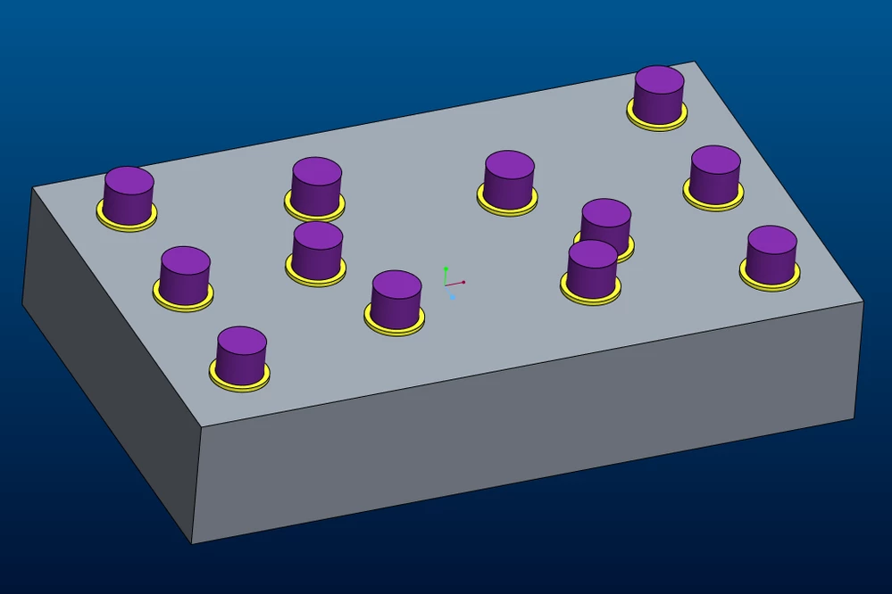

I use CREO3 M130 and i have some problems with the patterns functions.

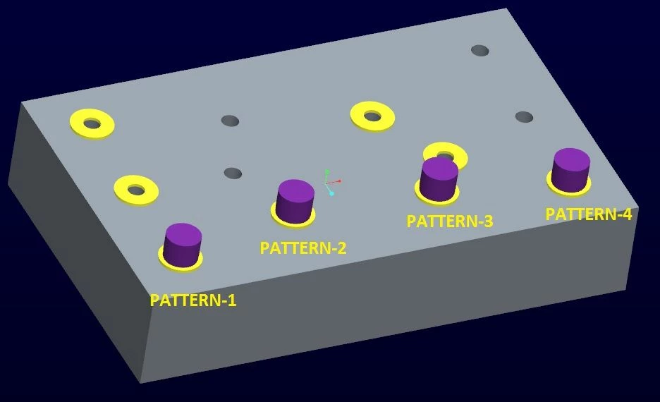

In this sample i have do different holes by patterns (dimension, axis, points and direction). In the assy a would use the pattern function by reference only.
1) Firts, for th part 2 (Washer) is it possible only for the pattern 1 and 3 not for the 2 and 4 Why ?
2) Second, i would like assembly the part 3 (Screw) on the washer and use the pattern by reference too. And in all the situations, not working.CREO3-M130 - PATTERNS.jpg

Change constraints for washers and screws from axis-axis to cylinder-cylinder. In this way all patterns works.
ldrutel1-VisitorAuthor
November 2, 2017
Great , his solution resolve the first point. Now i can pattern the all the washers by reference.
But, for the screw, i have change also the assy axis/axis by Cylinder screw/Cylinder washer and the pattern reference not work. It work if i assy the screw : Cylinder screw/Cylinder part1 and gap Surface screw/Surface part1 but this solution is not really the best.

I just changed constrains for screws from (screw axis)/(washer axis) to (screw cyl)/(washer cyl)Capture.PNG
