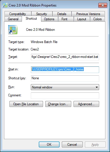

The best way I've found to handle this is as follows:
Make sure you have this config option:
load_ui_customization_run_dir yes
In my startup script I do the following: (This script is specifically for editing the ribbon file.)
1. Delete the ribbon file in the local cache:
a. del "%USERPROFILE%\pro\Creo_2_home\cache\no_pdm_cache\PTC\ProENGINEER\.Settings\creo_parametric_customization.ui"
2. Delete the ribbon file in the load point:
a. Del "C:\ptc\Creo 2.0\Common Files\M060\text\creo_parametric_admin_customization.ui"
3. Move any existing ribbon file in the run directory to a different location:
a. Move "%USERPROFILE%\Creo_2_home\creo_parametric_customization.ui" "%USERPROFILE%\pro\Creo_2_home\configs\creo_parametric_customization.ui"
4. Copy the admin ribbon file to the run directory: (Notice I change the name)
a. echo f|xcopy "P:\Creo 2.0\sys_configs\creo_parametric_admin_customization.ui" "%USERPROFILE%\pro\Creo_2_home\creo_parametric_customization.ui" /y /r
5. Delete the server registration information:
a. del "%USERPROFILE%\pro\creo_2_home\cache\no_pdm_cache\PTC\ProENGINEER\.wfwsi2008
b. del "%USERPROFILE%\pro\creo_2_home\cache\no_pdm_cache\PTC\ProENGINEER\.Settings\active_server_config.fld
c. del "%USERPROFILE%\AppData\Local\PTC\Creo\Platform\2.19\agent\ServerMgr\.srv_mgr_db.fldx"
6. Make sure I'm using the latest config file:
a. attrib -R "C:\ptc\Creo 2.0\Common Files\ M060\text\config.pro"
b. attrib -R "C:\ptc\Creo 2.0\Common Files\ M060\text\config.sup"
c. echo y|copy "P:\Creo 2.0\sys_configs\config.pro" "C:\ptc\Creo 2.0\Common Files\ M060\text\config.pro"
d. echo y|copy "P:\Creo 2.0\sys_configs\config.sup" "C:\ptc\Creo 2.0\Common Files\ M060\text\config.sup"
e. attrib +R "C:\ptc\Creo 2.0\Common Files\ M060\text\config.pro"
f. attrib +R "C:\ptc\Creo 2.0\Common Files\ M060\text\config.sup"
7. Set the cache location:
a. set PTC_WF_ROOT=%USERPROFILE%\pro\creo_2_home\cache\no_pdm_cache\PTC\ProENGINEER
8. Then start up Creo:
a. start "m060" "C:\ptc\Creo 2.0\Parametric\bin\parametric.exe"
This ensures that you are only using one ribbon file from your run directory, so all changes will get saved to it.
Go to File, Help, System information to see which files were loaded
* Should only be one ribbon file
Make your changes and then copy the ribbon file from your run directory up to your server location, and change the name so it has "admin_" in it.
I set the run directory in the shortcut to this script. (The "Start in:" field)
