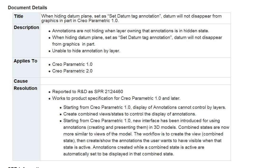

Howdy, I have a part in which I have created a datum plane to use for GD&T. I renamed it "A". I then set the datum and a datum tag appears. I move to the drawing and I can do everything I need to do. I choose to layer off all datums so the drawing always looks right regardless of you turning datums on or off.
But I can't seem toturn off thedisplay this datum tag of the plane in the part and any subsequent assemblies using this part. If I suppress the datum or hide the datum it disappears on the drawing. Putting the annotation feature created during the set datum on a layer and turning that layer off doesn't do anything.
Any suggestions?

Was this Creo 2? PTC, the changers of stuff that works, decided to change the way GD&T works with layers. No longer can you add GD&T datum planes to a layer and turn them off. Their recommend method it detailed in a TPI using combined states.

We did find this workaround also. Couple of things that need to be set correctly in the config.pro and the drawing setup file for this to work really nicely:
Config option:
Old_style_set_datum YES
This is the default setting so if you don't have it, you are able to use the "SET" instead of "SET DATUM TAG ANNOTATION".
Drawing setup file:
GTOL_DATUMS STD _ASME
If you are using the 1994 ASME Y14.5 or later, you will get the new datum style (with the triangle attachment) even if you set it as an old style datum in the model.
It works great and keeps the layer control of the datums available.
