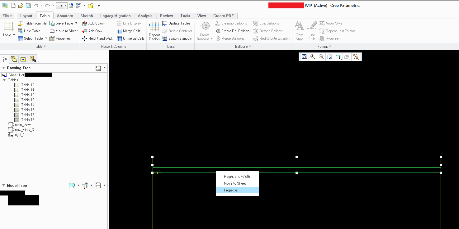

Hi All,
Would someone be able to tell me how to delete a row or column from any table in drawing mode? I've been looking for about an hour and still can't find a way. Appreciate any help anyone can give. FYI, I am currently using Creo 2.0.
Best answer by wjamieson
Just figured it out, I needed to remove the repeat region before deleting the row. (Through the Repeat Region button in the Table tab of the ribbon.) Thanks for everyone's help, I am new to Creo and not too used to everything yet!

Addition: I have seen the thread at the link below, but I cannot get it to work this way, when I click the right mouse button, there is no delete row/column option. http://communities.ptc.com/message/259226#259226help.png
January 29, 2015
Sure. Table tab>select/highlight the row>press the delete key on your keyboard (or Rt. click delete)
wjamieson1-VisitorAuthor
January 29, 2015
When I highlight the row and press the delete key, nothing happens. When I right click, there is no delete option in the task menu (have a look at the attached drawing in my previous post.) Which version of Creo do you use? I appreciate your help.
January 29, 2015
Do you know if the table has a repeat region in it?
wjamieson1-VisitorAuthorAnswer
January 29, 2015

Not sure is this the correct solution, but it work.
1> Click on repeat region button in table menu and click remove in pop-out window. (For repeated region)
2> Select the row or column you wanna delete (By selecting the most left line for row, most top line for column), it will highlight the whole row or column instead of just a cell.
3> Press delete on keyboard.
