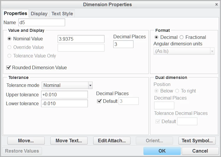

I'm coming from Wildfire 4, so I guess I may have zoned out on previous discussions about this issue.
I've played around a bit in Creo 2, I'm not sure I would call what I'm seeing an enhancement. We work on some highly accurate parts, it not uncommon to use 4 digits in inches and 3 digits in millimeters.
I entered 3.9375 in the sketcher. The sketcher shows 3.938. Finish the feature and measure, it shows 3.9375. Double click on the feature to show the dimension and it shows 3.938. double click on the number to edit it and it shows 3.9375. The drawing shows 3.938. Edit properties on the dimension and it shows this.
[cid:image002.png@01CDB6A5.678682A0]
This is different behavior than in Wildfire 4.
What config options control this behavior?
* What settings make it like I see out of the box in Creo 2
* What settings restore it to traditional ProE behavior?
Why would I want the new behavior?

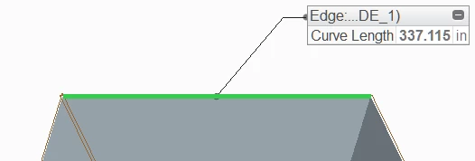

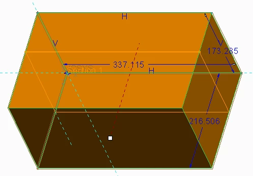

1. Create a new part
2. Sketch a rectangle and don't type in values for the dimension, just drag them to what you want.
a. My case the displayed values were 337.115, 173.235
3. Drag the depth, do not type in a value
a. My case the displayed value was 216.506
4. Measure the three lengths. The displayed values were 337.115, 173.235, & 216.506.
a. [cid:image002.png@01CDB73F.C5CC5DE0]
5. Now double click on the feature to see the dimension.
a. [cid:image003.png@01CDB73F.C5CC5DE0]

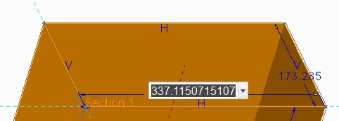

6. Now double click on the dimension.
a. [cid:image004.png@01CDB740.123FBF50]
Doesn't anyone have a problem with this???????

And another thing, In the sketcher I noticed if I select a dimension and uncheck Round Display Value from the RMB menu. I get to see the full value of the dimension. But you have to do this for each dimension.
[cid:image005.png@01CDB744.580FEBF0]
David Haigh
davehaigh13-AquamarineAuthor
October 31, 2012
Ok, So if you set the config option:
Round_displayed_dim_values no
The sketcher shows the full value for all dimensions.
If you set the config option:
Sketcher_strngthn_to_def_dec_pl yes
(the default)
When you click on the dimension and then pick Strong from the RMB menu, it will round off the dimension to the number of digits set in default_dec_places.
This means if you forget to strength any dimension, they will remain at 11 decimal places.
