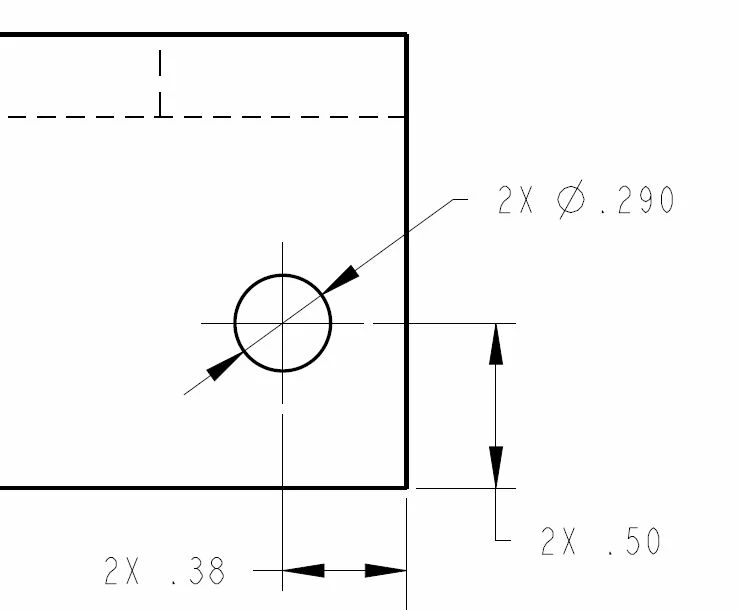

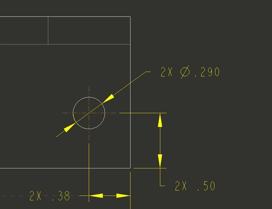

Can anyone explain what controls how Creo scales center, hidden, and phantom lines, when printing or exporting? This is a problem I've ignored longer enough -- hopefully someone can provide some insight for me.

Might help if I attach the correct image ....

l´m almost sure that right settings are hidden somewhere in PEN TABLE FILE. *.PNT extension. These file is responsible for 2D drawing to PDF printing output.
Don´t know exact enswer, but can give you some directions:
- see attached file with basic informations about *.PNT file
- see ProE help about PEN TABLE expression
- see PTC community for PEN TABLE expression
Milan
2-Explorer
June 22, 2016
Have found some more simplier PDF "manual" about *.PNT file.
Please Refer:Suggested Technique for Creating Table.pnt files and Setting Default Pens
Hope it can explain many question...
