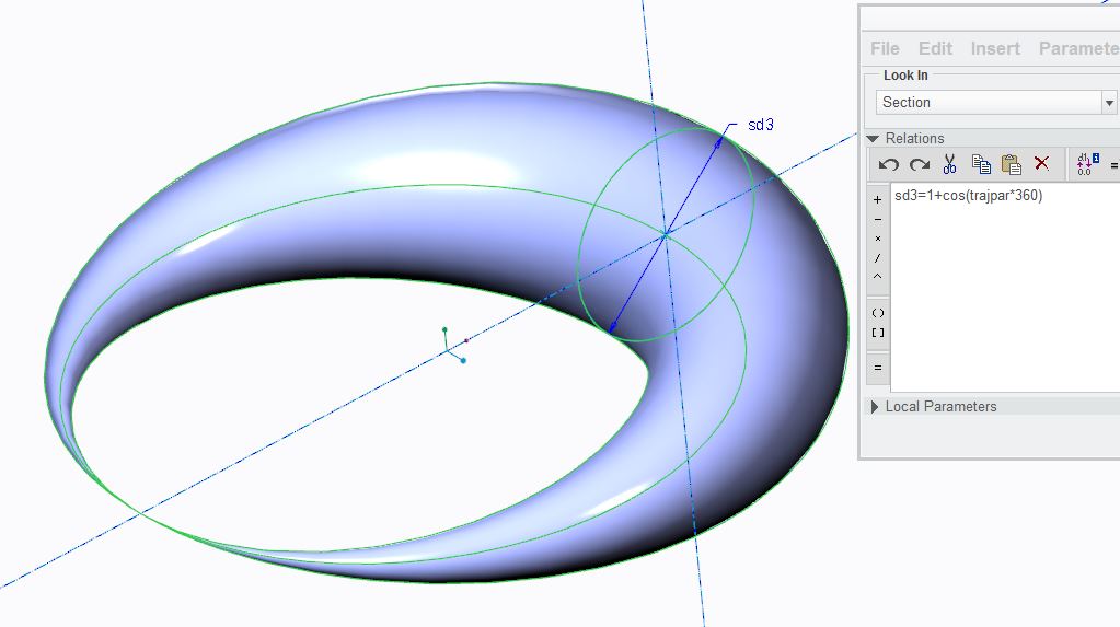

A line with variable length: sd3=1+cos(trajpar*360) - the value statement "1+" is to ensure no negative value exists.  The value of cos(trajpar*360) is +1 to -1 and back to +1 (90 degree ofset sine wave).  So the line is 2 long at the start; 0 long at 50% along the trajectory; and back to 2 at the end.VSS_line-zero.JPG
A circle with a variable diameter: As in the line above, the circle diameter is 2 to 0 to 2 again.

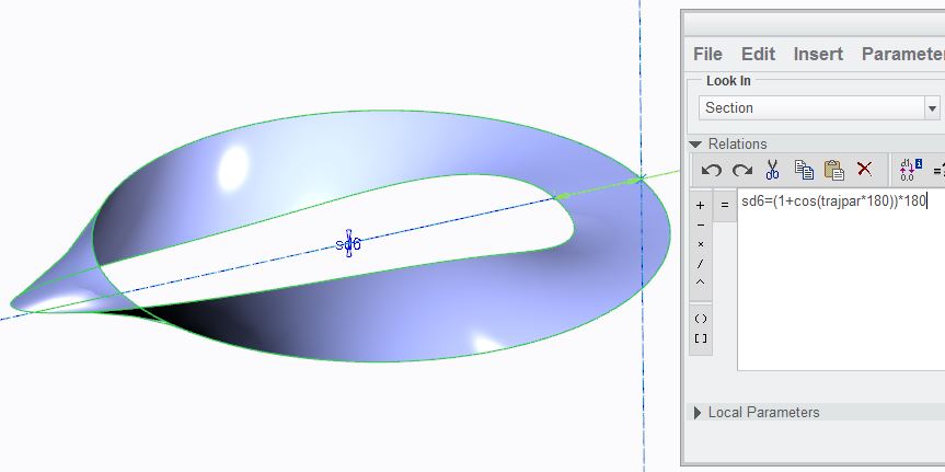

VSS_circle-zero.JPGRevolving a line along a closed trajectory is little more complex, apparently.  The reason for this is not immediately apparent.  In this case, the value range is 1 to -1 and not back to 1 (half the cosine wave).  Also, the full range -must- convert to "360" or multiples there-of.  The same "1+..." statement is to convert the value range from 2 to 0 (all positive or zero).  The "...*180" makes the value range 0 to 360.  But also notice the "cos(trajpar*180)".  In this instance, we only want one direction of rotation from 360 to 0.  This is the special condition where 360=0 and therefore abides by the basic rule #1; the end condition must be the same as the beginning.  Any other value in this statement that does not result in a value following rule #1 -will- fail.  However, this particular closed loop with a revolving section does not require a sine function.  In fact, you can revolve the line linearly using "d(n)=trajpar*360".  Again, for the very reason that this range of 0 degrees to 360 degrees create the same end condition as the start condition.  Try replacing "...360" with "d(n)=trajpar*(360*20)" in the Relation for multiple loops around the trajectory path similar to the next example.

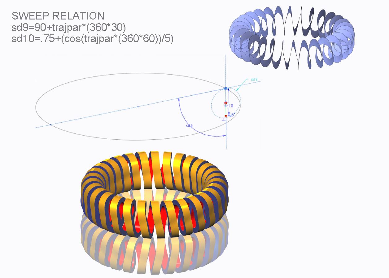

VSS_angle-zero.JPGof course, these are simplified examples but the power of these equations should be self-evident.  The following examples show that angles with values greater than 360 are allowed: sd9=trajpar*720...
In this instance, the open trajectory uses "trajpar" directly using the value 0 to 1.  sd9 is an angle dimension where at the start of the trajectory "0*720=0" and at the end, "1*720=720".  This creates 2 full rotations of the line defined by sd8.  Now see what happens is you replace this with a curve function by replacing the sd9 statement with "sd9=(1+cos(trajpar*180))*360".  Notice how the ends are now beautifully tangent to a horizontal plane.

I did add an update as I realized that you can use angle trajectory parameters without a sine/cosine function on a closed trajectory path.  A linear whirling of a line around the trajectory path is perfectly all right as long as it ends where it began.  Just thought it was worth noting considering I did it here earlier today:

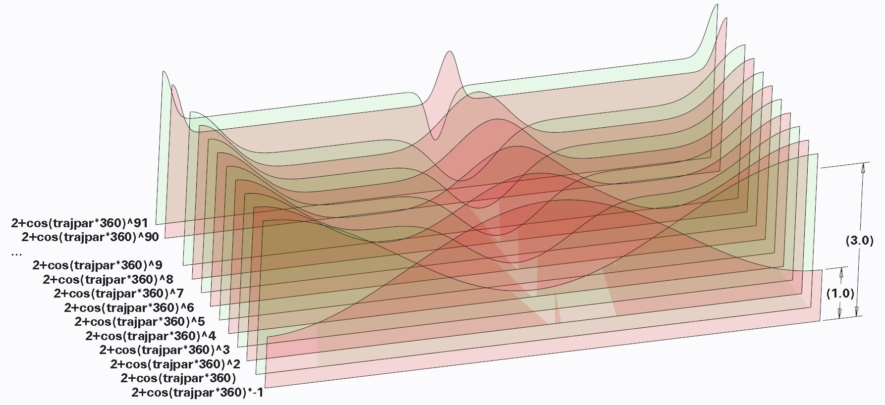

I added an image to the tips photo album that seems appropriate here.
Sometimes a pure sine wave is less than optimum.  Here is a simple way to change the cos(trajpar) statement to get some interesting results:  Note the inverse using "-1" and even raised powers (red) change the range from +/-1 to 0-1.  This is useful for motor profiles and datum curve equations also.
I know the math guys know all this, but it is certainly worth posting in this discussion.
