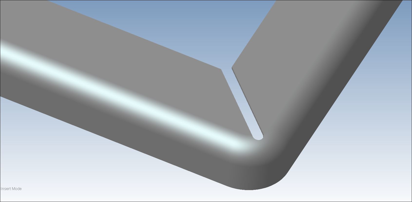

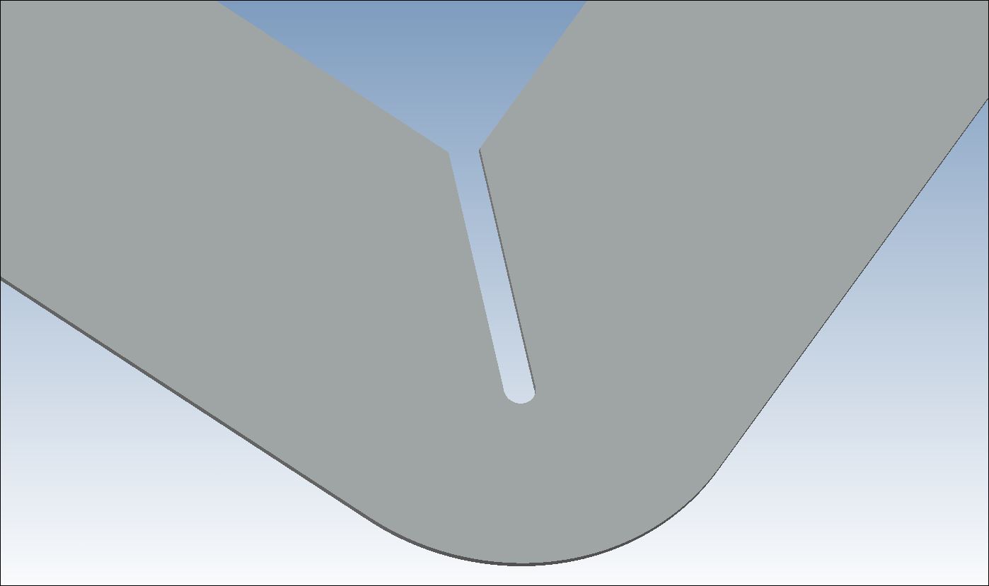

I did this years ago in Wildfire and sheetmetal did not know how to flatten it, but it was good enough.  The part was originally a solid model (shown below) and am attempting to create filled corners in sheetmetal because the part is made that way.  See the pic below for solid model corner.
I have tried various ways in sheetmetal to fill the corner in and currently only a sweep fills in the corner, but only as a surface.  When choosing Solid (sweep as wall) sheetmetal is incapable of creating the geometry.  I am going to continue trying, but hoping someone has figured out how to do this?

I went to Failed Geom and the following displays so I think I have a clue?

This is something Creo sheetmetal can't handle. Creo sheetmetal only does straight, non-intersecting bends when it comes to bending and unbending.
The math for those bends is straightforward.
Once you get to intersecting bends, you get deformation that is not simple math. You would then need tooling (forms and dies) that gives you the desired shape.

Creo doesn't do corners well.  And if you try to fix them, it doesn't do fold/unfold well.
So you have to pick your poison.  Do you want good geometry or do you need flat pattern capabilities.
Otherwise, you can always convert your part back to solid model and work with it at your content.
I only need flat pattern from time to time.

please, see attached file for some idea.
Check deformation control tab in unbend feature
Creo 3.0 commercial

Thanks everyone for replying.  Thank you Darek for the model.  Funny to see how it treated the two right side corners.  I am where I am and still am going to attempt to solidify the corners and hope it will flatten
Yes Antonius I do need the flat pattern, not only the flat pattern but they want the stages of the processed part.  That is being done with bends/unbends using a family table.

With regular press brakes, you really can't get to that part. The straight bends are easy and can be fully calculated by creo (if you have the right k or y values) but the deformed corners are gonna get you. It's a much more involved process than what creo can calculate. There is wrinkling and stretching and thining that creo can account for in the math.

Attached file is the similar corner design with the cut and full round crossing the bend
Please, resume the unbend feature.
Edit: attached file corrected
