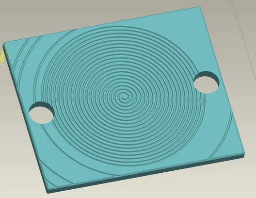

OK group,
I have a model that is giving me fits. I want to make a plate with a
spiral cut. I have attached a jpeg example. The spiral cut uses a sweep
with a sketched datum created by equation.
Here is the curve equation:
r=.01+t*(.65-.01)
theta=t*360*33
z=.0505
The plate is 0.04 thick and 0.84 by 0.99 with 2 x 0.125 dia holes.
As soon as the cut intersects open features it begins to fail. Anyone
have any ideas?
I am on WF2 , but am open to solutions with WF4 as well.
I can send a part file if anyone is interested.
Jeff
