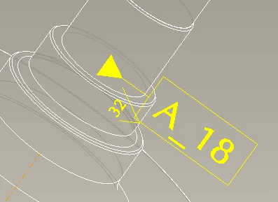

Chris wins the prize. Thanx.
I had shown one of the other axis on my drawing but apparently you need
to show the axis that the datum is attached to. Also, unfortunately, if
you don't select to show 'axis' in the Show/Erase dialog, it won't show
the axis labels even if you have selected to show "datums" in the box.
Go figure...
Thanx for all the help.
T
