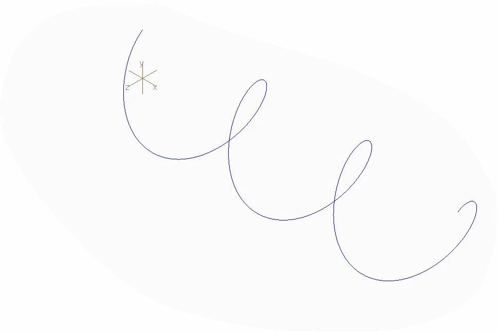

Hi, This can be done using Creo with ease!
Simply create a datum curve defined by an equation! (or in this case three equations).
The only other feature required is a csys.
Creo Helical CurveCreo Helical Curve
I uploaded this model as an example of a helical curve which is defined by three simple parametric equations...
x = 5*t
y = 2*cos(t*360)
z = 2*sin(t*360)
In this case,
The helix is projected along the x axis with pitch = 5 units.
The shape is defined by the equations for a circle in the y-z plane using cartesian co-ordinates, with radius = 2 units.
The helix is right handed.
t is a system parameter which varies between 0 and 1.
Please open the model and explore its interesting properties.

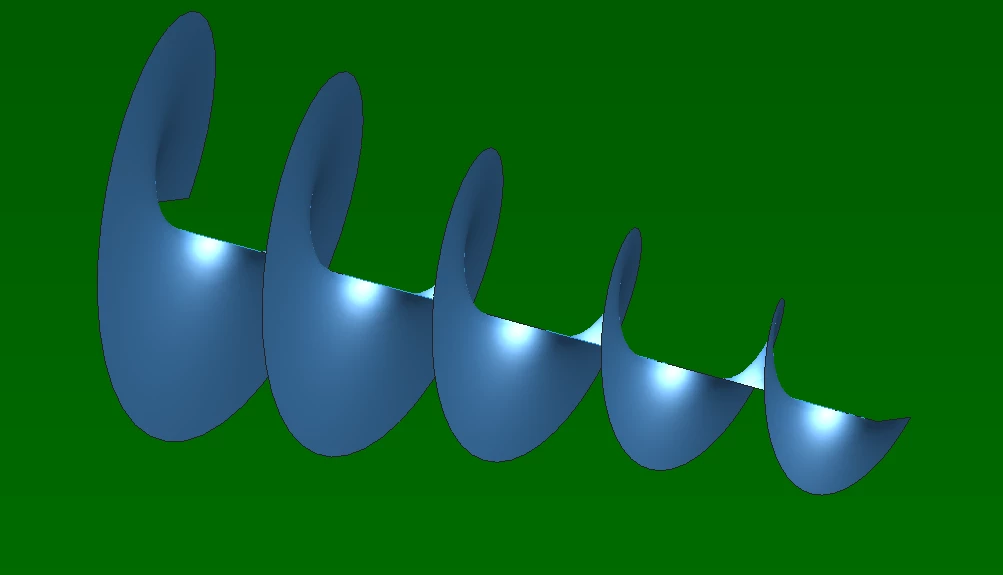

I realized after making my post that i can almost achieve my goal but i end up with a redundant surface which i guess isn't the end of the world. I figured I could just use the Helical Sweep feature & sweep a surface in the form of a straight line along my sketched profile, then I have 2 edges I can use for my helix curve.

Thanks for the reply, see my response to the first, I think the same applies. I have attached an image of my requirement & my solution.helix_to_profile.JPG

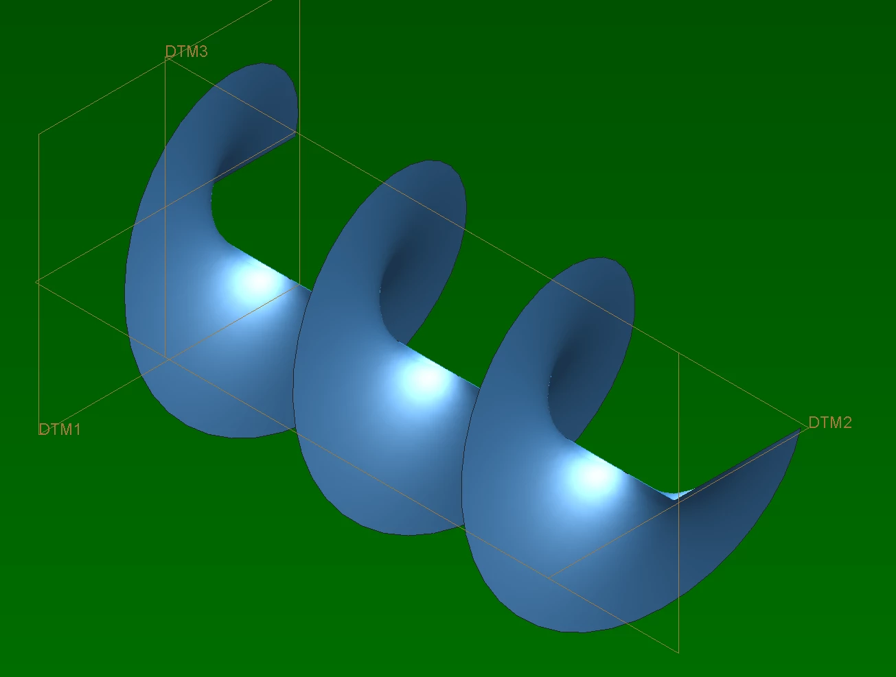

Hi, I tried to solve by adding another equation to the sweep. Is this something you have in mind?
Oct 3, 2017 1:57 PM UTC
Thank you for your reply. This is the same as my approach, the image I posted earlier was done in Creo using Helical Sweep just as you show. The only disadvantage to this method is I end up with a redundant surface once i extract my helical curve/edge. In Catia, it appears you can create the helical curve without the surface, so you don't have to deal with hiding it somehow or merging it with other surfaces.

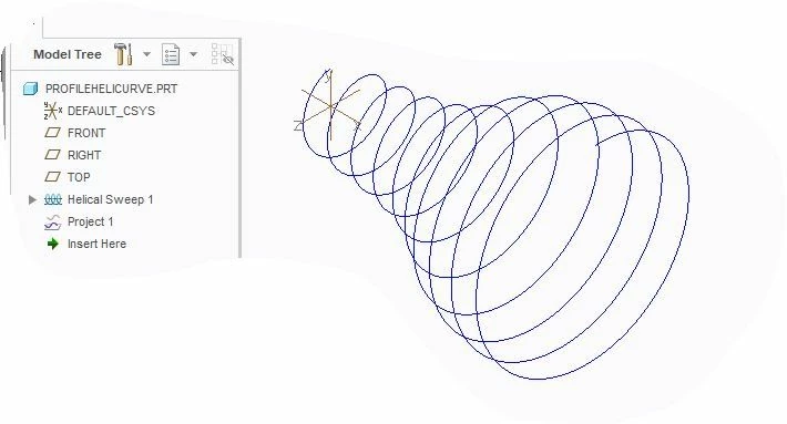

Hi, I used your method to create a datum curve by projecting the edge of the sweep surface onto the surface of the sweep. I've placed the sweep on a layer and hidden it (I don't see this as a significant drawback). Seems okay and accurately follows the profile. Only two features and relatively straightforward procedure.
Creo Helical Curve Following a User-defined ProfileCreo Helical Curve Following a User-defined Profile
I think Ken is dead right about the maths and taking the route using parametric equations. That would be difficult and time very consuming, requiring a different solution for each profile.
