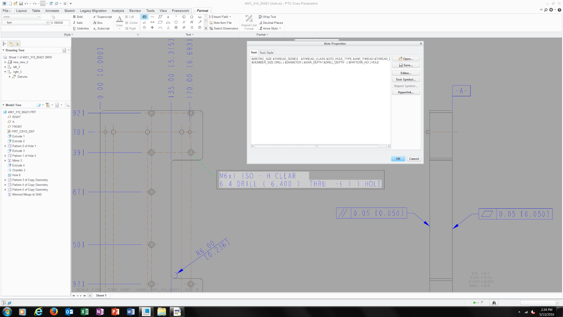

Greetings:
I'm really struggling to understand Creo's drawing module and one of the issues is hole callout.   I was told that the drawing mod.  does have that ability and you have to use 'Show Model Annotation"  weird but okay.  So I found out a how have hole call out show but the callout is not what I was expecting.   Need some help on this been at it for 1/2 cay and still can figure it out.

It's very much like creating notes with displayed dimensions. I'd say first determine whether you are going edit the standard tables or create your own. If you create your own, make sure THREAD_SERIES in the header is set to what you want to appear in the thread specification drop-down of the hole feature, as this is what is shown, usually the same as the hole table file name.
Under CALLOUT_FORMAT add the parameters and other text and symbols you want to show, any column heading in the hole table file is valid. Try starting with 1 or 2 parameters such as:
&FASTENER_ID &THREAD
then try adding symbols:
<CTRL-a>x<CTRL-b> adds the depth symbol. Try different values to see what you get, I haven't found a list that shows what letter gives which symbol.
Also look up Formatting Thread Notes and there is a link to the valid parameters for use in the CALLOUT_FORMAT.

Try this and see if it works. Start out with a variable depth hole adding the countersink and counterbore individually to the hole. The hole note should display the thread call out as the default and when you add a countersink or counterbore it should add the appropriate information. After you see that work change the hole type in the hole feature to THRU_ALL, when you do that the only thing that should display is the thread call out. If you add the countersink or counterbore you should only see the thread call out displayed, save your file and close. Go to the *.hol file and edit the DRILLED_DEPTH value for the desired hole to THRU_ALL, save *.hol file and re-open Creo. Edit the definition of the hole, select the Note tab, and select Reset. If the sequence was done right you should see the correct information displayed.
