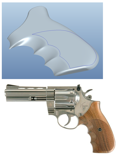

How can I "pattern" on this curved surface?
How would I model the portion of the handgrip that would be inside the blue curve? Pattern is in quotations in the subject line because your suggestion does not have to involve an actual Pro/E pattern. Just explain how you would accomplish this, but I don't want to use a textured image. I want to explore the solid modeling options.
I'm using Creo Elements/pro 5.0 with ProE/Foundation Advanced
Details:
This is just for learning and fun. I created the surfaces and had to stop because I don't know how to get the texture on there. I don't know the shape of the individual pieces that make up the texture, but I think its a 4-sided pyramid. Make the shape be whatever makes your solution possible.
Goals:
1. The patterned entitites should have no space between them.
2. The entities should have a constant height as measured from the curved surface.
3. Try to make the entities terminate at the blue curve, not before or after.
* The .prt file is attached.
Have fun and teach me and the other readers a few things.

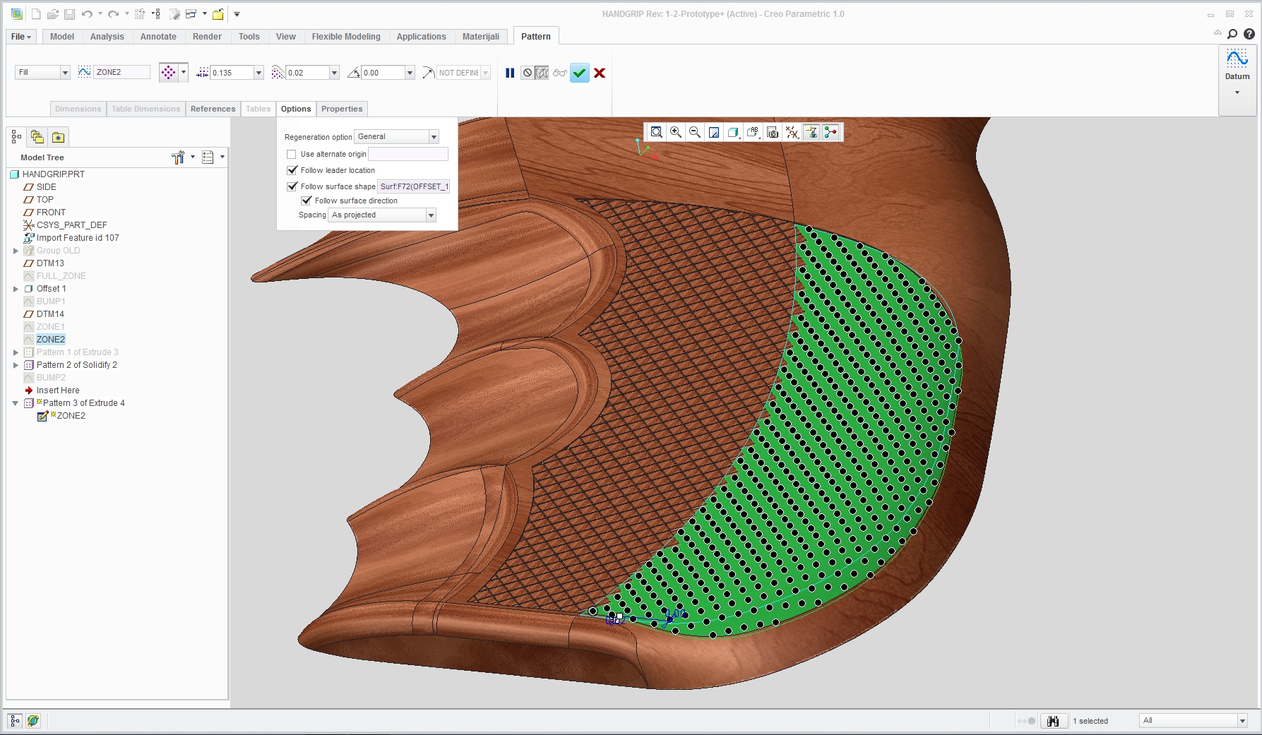

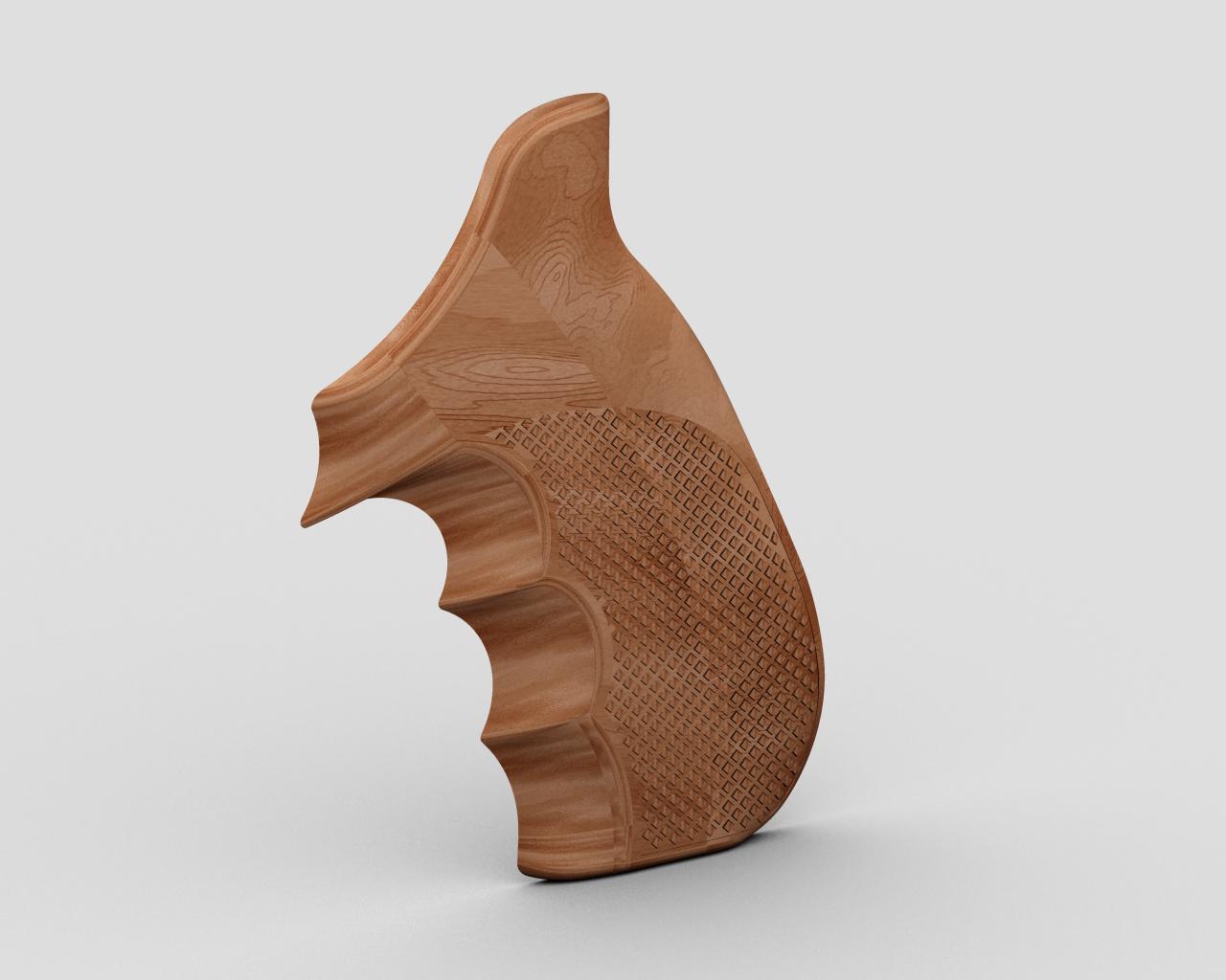

Here is screenshot of dashboard. Here i made pattern with no gap between entities.
Its basicly 2 patterns. I had to pattern extrudes that are surfaces not solids, solidify and then reference pattern of solidify feature. This is because there are problems when entities are patterned next to each other on curved surface, they tend create errors with geometry.
Diamond shape is basicly extrude with taper.
Sorry for late response.

Kevin, i found your request quite challenging.
"1. The patterned entitites should have no space between them."
Unless there is a V or U groove between entities you will get nice big surface from merged little ones.
And there lies the problem i have, overlaping entities that create havoc. I used fill pattern projected on surface.
Your surface that you wana fill with entities is actualy made of 2 parts, one flat and one curved.
I tried patterning diamond shaped surface not solid and then solidifying it and pattering that but that gave me slightly better result.
Maybe solution lies in patterning groove section instead of diamonds.

I like your image. Its better than I could make. I'm bit confused about your explanation, though. Could you restate it and add more detail, possibly some screen shots of the menus? Specifically, what did you mean by "fill pattern projected on surface"?
Thank you,
Kevin
Jan 26, 2012 5:44 PM UTC
hi,
I think Davor has used this technique: http://learningexchange.ptc.com/tutorial/778/using-the-fill-pattern-tool
(at the end of the vid)
Not sure how he got the triangular shape or diamond shape.
