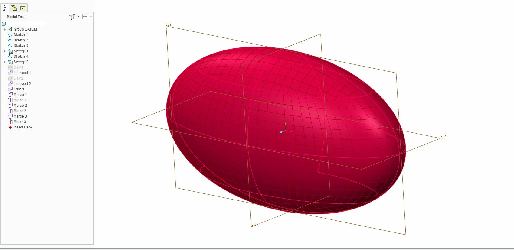

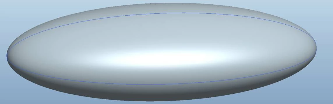

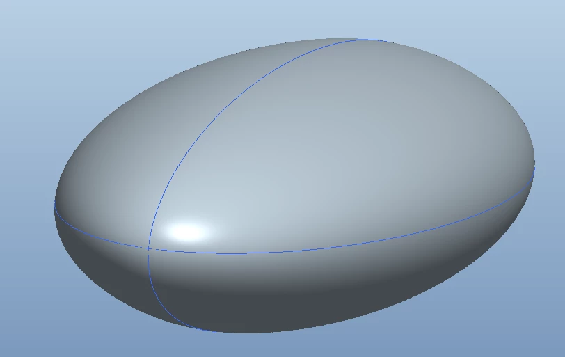

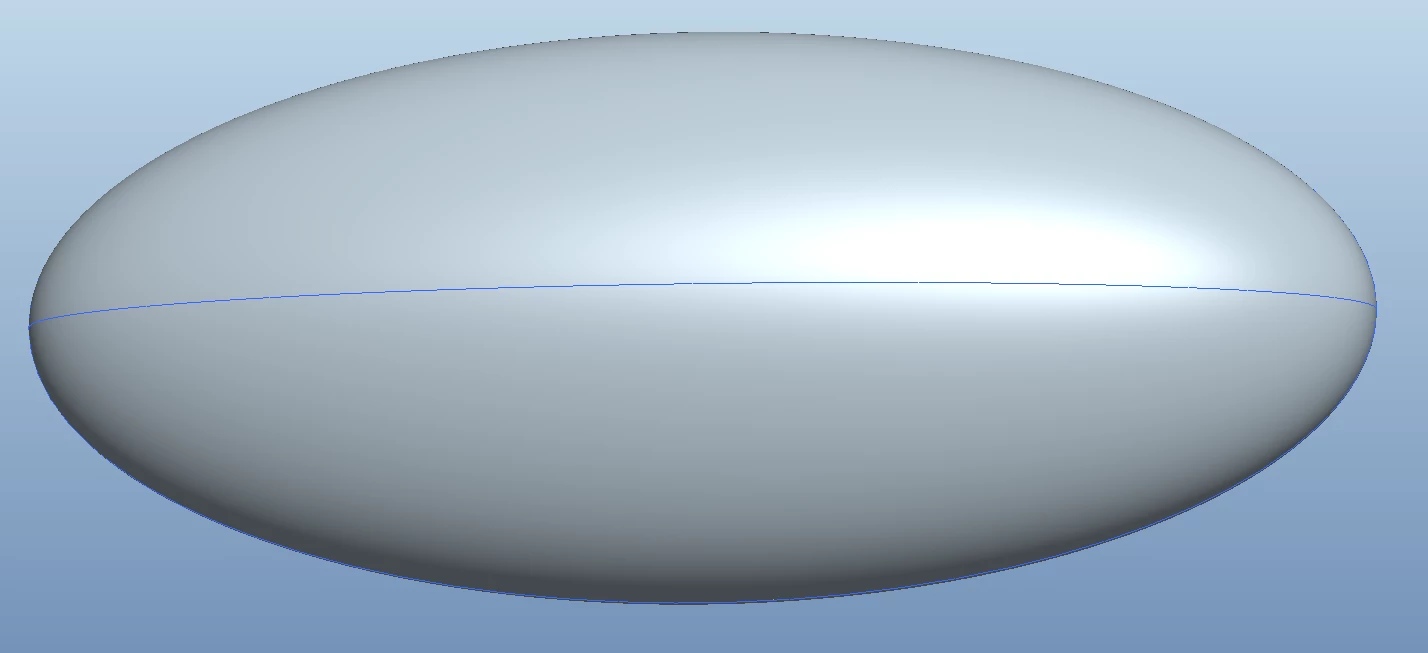

Like this?
[cid:image001.png@01CE9CE3.2E7F0A70]
[cid:image002.jpg@01CE9CE3.2E7F0A70]
[cid:image003.png@01CE9CE3.2E7F0A70]
August 19, 2013
Yes I think so, can you highlight the profiles on the 3 datum planes, they
should all be ellipses. How did you create it?
August 19, 2013
I suggest creating 1 quarter of this and mirror and merge and then another mirror and merge.
Start by creating one of the elliptical halves of either frontto top view. Make sure the end points of the curves are vertical or normal with the adjacent datum plane. If not you will end up getting creases where the halve merge.
Next create the elliptical curve in the other plane. Make sure the end points are like done before (vertical/normal to adjacent DP, but also coincide with the end points of the first curve.
Next create a boundary blend using those tow curvesfor the first direction and no curves in the second direction.
Set the constraints for each curve to be normal.
Next do the mirror merge steps and should be good with no creases.

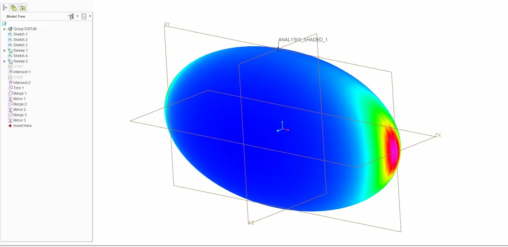

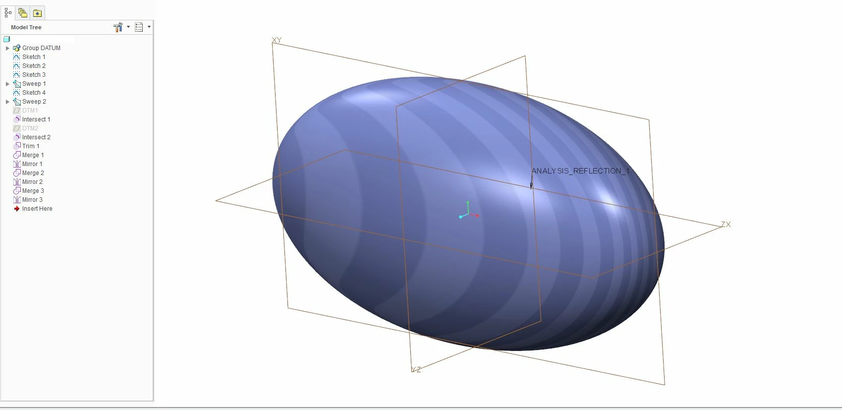

This can also be done with a few construction curves and two variable section sweeps sketched with conics.
Surface quality may be a little better than a trimmed back boundary blend.
Mesh is definitely better than a 3 sided quilt with singularity
The technique was documented and demonstrated here:
http://www.mcadcentral.com/creo-modeling/17699-nose-c-ne-help.html
