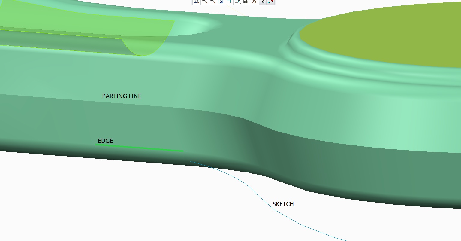

I will attach an example of the issue I'm trying to resolve.
In the attached you will see 3 different labels.
SKETCH: I wish to develope a parting line with this sketch but there is a negative draft in the twisted parting line of the customer model (in the area where the sketch intersects into the model).
PARTING LINE: In the area with the label this would be negative draft if viewed from the bottom view. This needs to be pulled out a specific distance.
EDGE: This is the edge in which I'd like to extrude draft out to intersect with the depth of the parting line. I would transfer this new location into my sketch to obtain a parting line split that will be drafted both ways in the Z direction. The resulting drafted extrude will not remove material in the area of the EDGE. The draft will not be negative in either direction of the split.
The obvious way to move out my parting line sketch in the area shown would be by developing a drafted extrude off the specified EDGE area which would be intersected out on a parting line surface and be referenced into the sketch.
Is there any way I can get the needed drafted extrude?

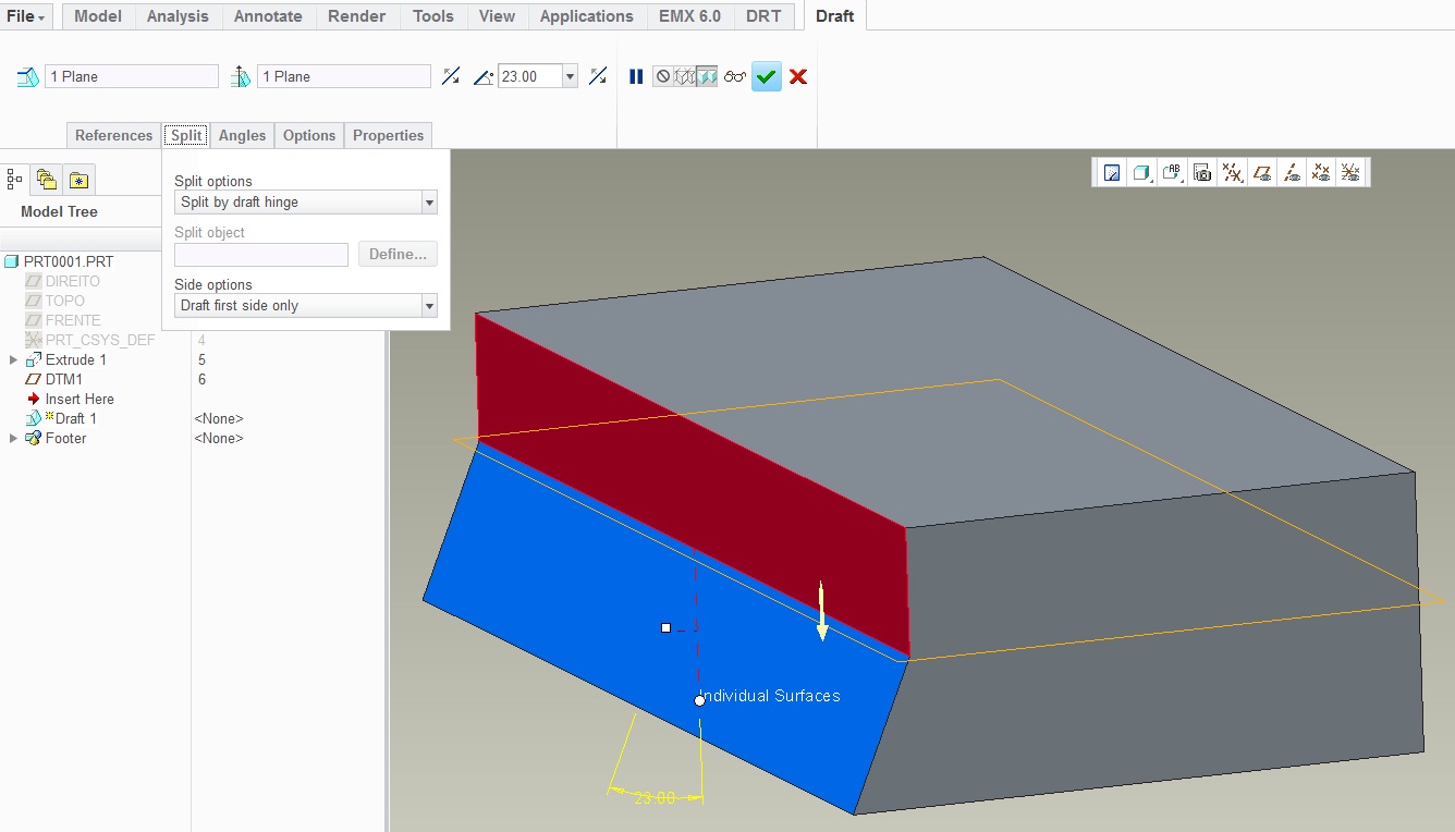

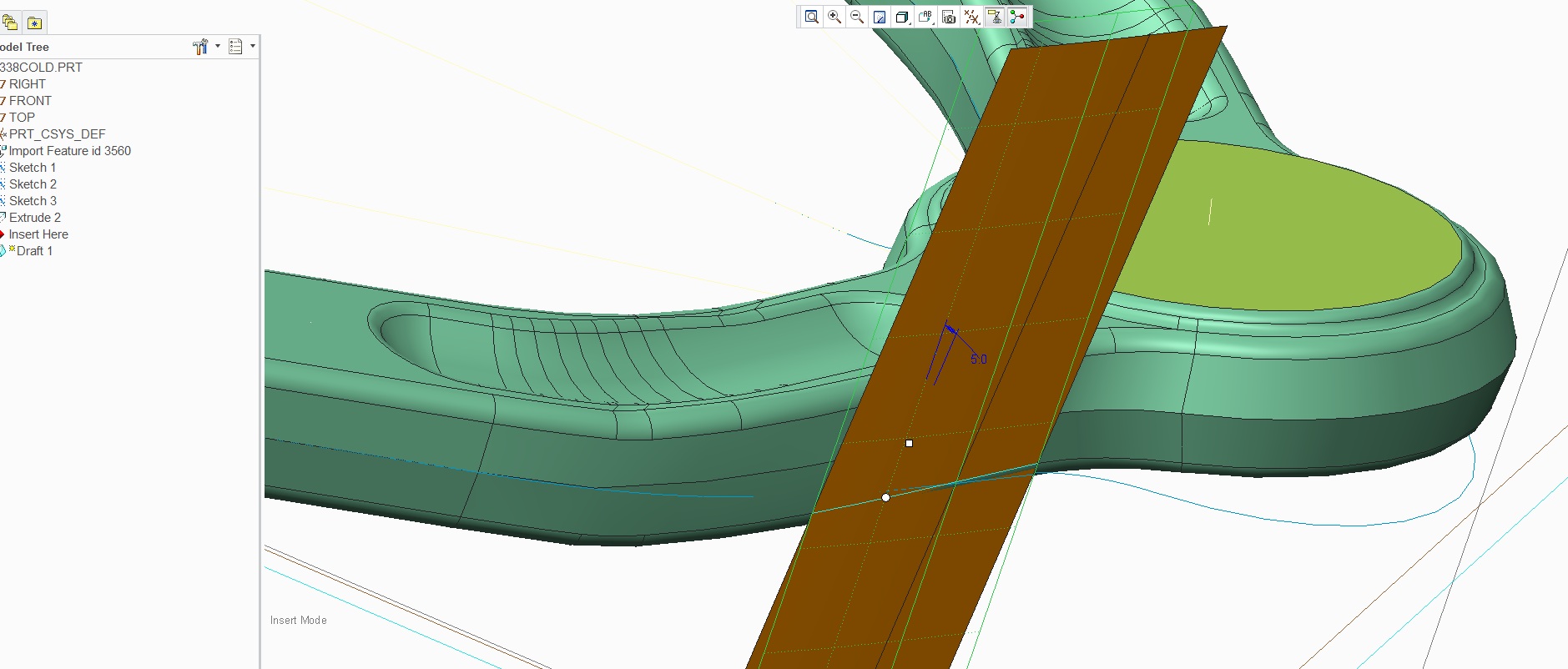

My need was to extrude with a draft on a specified locked edge. This is what I needed to do to accomplish this:
1) Build sketch using profile of the needed edge.
2) Extrude this sketch in the Z direction
3) Draft this extrusion using the imported models edge as the hinge.
I still am crossing my fingers that eventually Creo will be able to extrude directly from an edge.

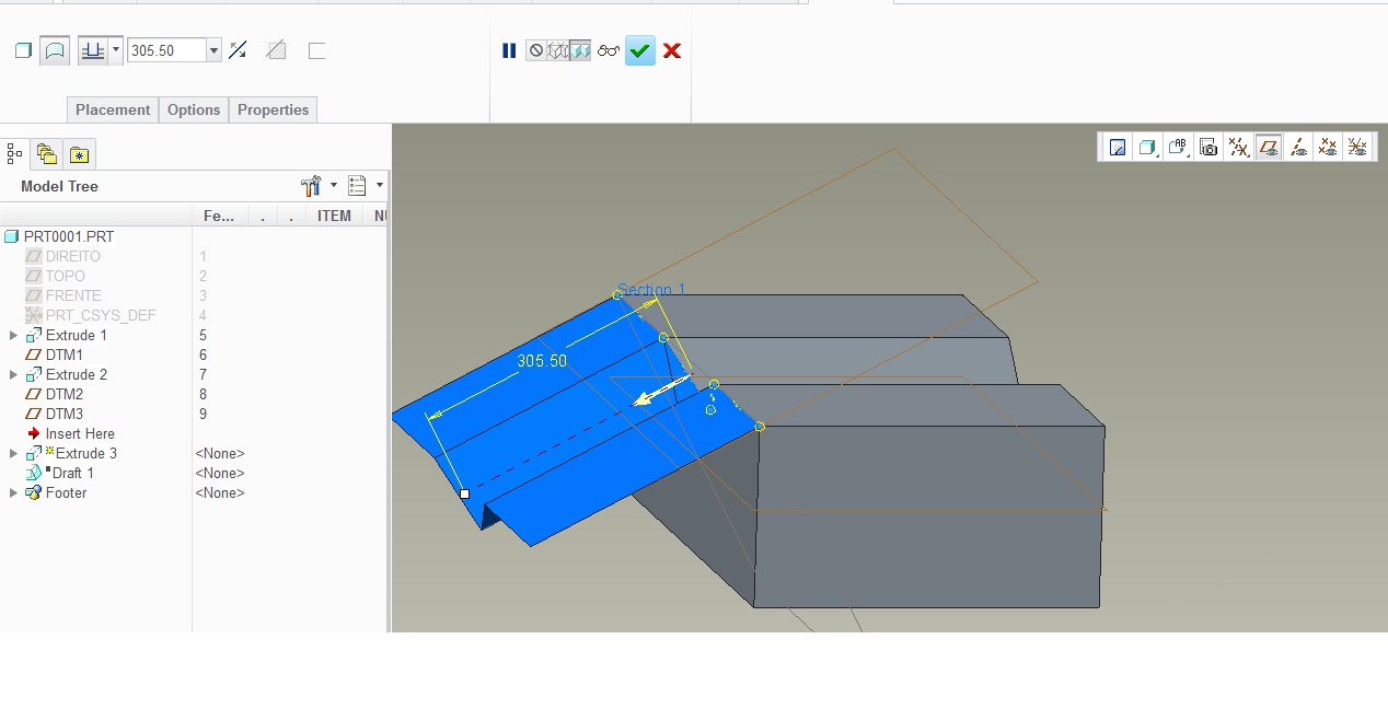

hello
why don´t you create a plan with the angle you need, then you create another plan 90º from the first.
if you creat a sketch from the second plan, (using the project tool,and select the edge), when you extrude it will be with the correct angle...
you can also create a skirt surface (only on .MFG) and give the direction you want
You could also creat a flat surface, than you could add a draf split the draft from the
Hope it helps...
