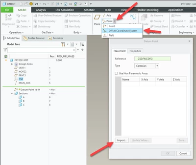

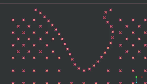

I’m working on a project in PTC Creo where I need to plot hundreds of points on a curved surface based on predefined X, Y, Z coordinates. I’ve already created a table with these coordinates and successfully imported it into Creo, which generated an accurate set of points. However, in the Model Tree, the points are recognized as a Table Feature rather than a Sketch Feature. My goal is to have these points appear as part of a Sketch Feature to enable better manipulation and integration into downstream modeling tasks. Is there a way to directly import or convert these points (or a .pts file) into a sketch? Alternatively, are there any efficient workarounds or automated methods within Creo to achieve this? Any suggestions or guidance would be greatly appreciated.

I don't know how to import points to a sketch.
You can import as datum points, using points offset from coordinate system. Does that help?
You can also create one point at 0,0,0 and then use a pattern table to get your points.

Hey there, thanks a lot for your response.
My final objective is to import the points which has to be placed "on a surface". (ref: the points image I have attached above have to be positioned on a surface which I find a bit tricky). To be entirely precise, the point coordinate data I have made in my table needs to be imported into creo and all those 100s of points have to be placed directly on the desired curved surface.

Did you try what @StephenW suggested? Thats the best approach. Make a CSYS on the surface where you want the 0,0,0 to be and then import the points as a point feature using that CSYS. The pts file format is just X Y Z with spaces in between the numbers.
