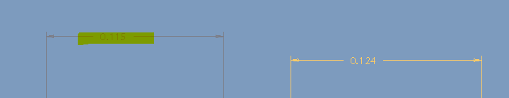

Hi folks,
How to delete/hide weak dimensions in sketch mode?
AraviK
    Best answer by gkrishna
    Right click on graphics area in sketcher > Option>in sketcher preferences dialogue>uncheck weak dimensions.(make a map key if you like)
    config.pro option : sketcher_disp_weak_dimensions no
    20 replies
    December 18, 2013
    Creo makes a sketch fully constrained by adding weak dimensions.
    Without them, Creo doesn't have enough information to create the sketch.
    You can add extra dimensions, or edit the weak dimension, to make strong dimensions.
    The weak ones that aren't needed anymore, will disappear automatically.

    December 18, 2013
    The weak dims are still controlling geometry and are therefore necessary. If you don't want them, you need to add other constraints or dimensions to constrain the sketch so that they are no longer necessary.
    December 18, 2013
    I thought the better method was the way PTC set it up - make the weak dimensions almost the same color as the background so they were not noticeable. It should be easy enough to match the weak dimension color to the background, rendering them invisible.

    gkrishna1-VisitorAnswer
    December 18, 2013
    AraviK11-VisitorAuthor
    December 19, 2013
    Thanks to ptc-4684141.
    This is what exactly i want.
    Thank you so much 🙂
