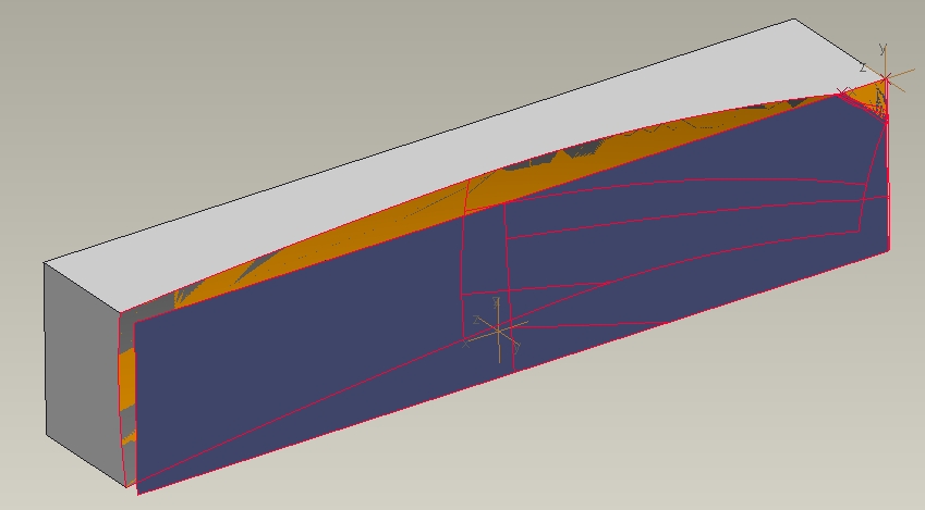

Hello all,
Anyone to try and flatten this quilt (feature TO_FLATTEN). Maybe some extra pairs of eyes can see something that I'm not figuring out (or it's impossible to flatten).
File is in Creo 1.0.
Thanks for any help.

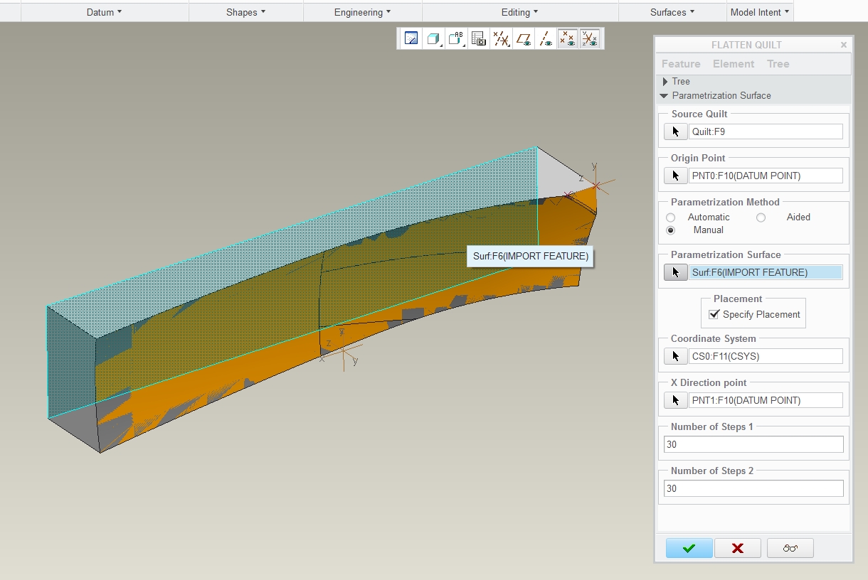

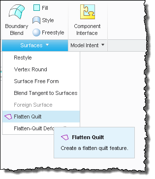

Hi Antonio...
Use the Flatten Quilt feature from the Model Tab. The menu is shown below.
To use this feature, you need to create a datum point directly ON the surface of your quilt. The feature is easy to use... it's almost self explanatory when the dialog box pops up you'll figure it out.

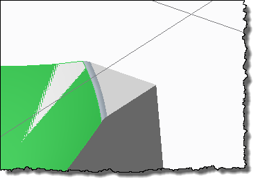

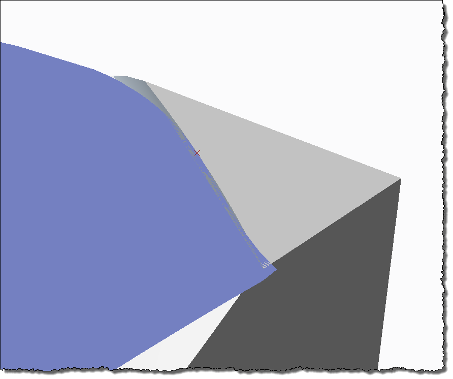

There was ONE small reason Creo was having difficulty flattening the piece... the small round and flat triangular region in the upper right hand corner as shown below...
I removed the round and triangule surface from the quilt and then the Flatten Quilt feature worked just fine. The resultant surface is shown below...
I just went back and tried the same Flatten Quilt feature WITH the round added back in. It still flattens. As I suspected, the real point of failure is the triangular surface which is ALREADY FLAT. Not sure if this helps or hurts though!
I reflattened the quilt using a point on the round (right at the edge). The result is below...
flat_surf4.png\
Zooming in on that upper right hand corner...
Notice the small red "X". That's the point I used to flatten the quilt. Not sure if any of this is giving you what you need or not.I'm also not sure what to do with the triangular area. Write back if you have more questions... I hope this did SOMETHING to help.

Hi Brian, thanks again for the valuable help, you surely did SOMETHING to help.
In fact I've managed to flatten it but you went a little bit further by adding the radius (which I didn't try). The radius was added by me because without it Creo will warn you that the surfaces are not tangent.
I've also managed to obtain this (image below) using the Manual Parametrization method and specifying the back surface as reference but the result doesn't seem very accurate. With this type of method i'm able to include the triangular surface.
Thanks.

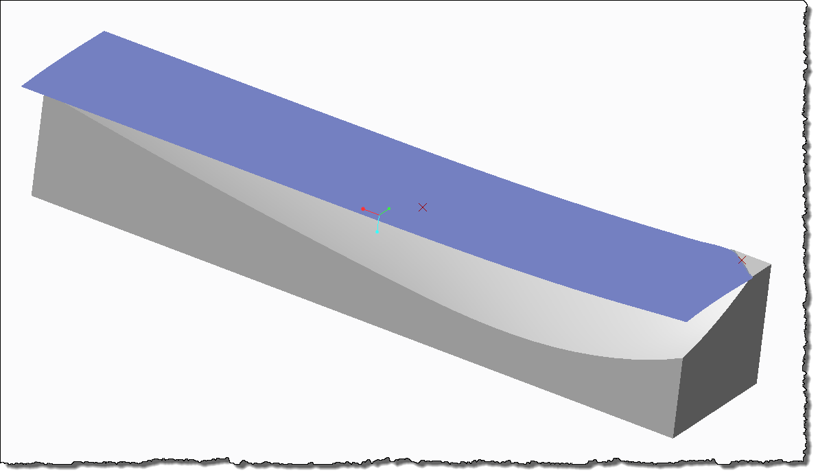

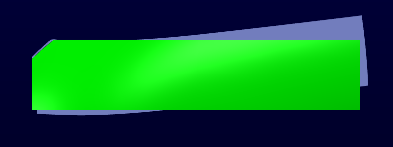

August 29, 2012
This is what I ended up with using Brian's method using automatic no specified placement:
Green is original surface and violet is the flat surface.

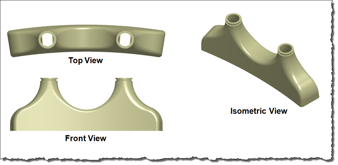

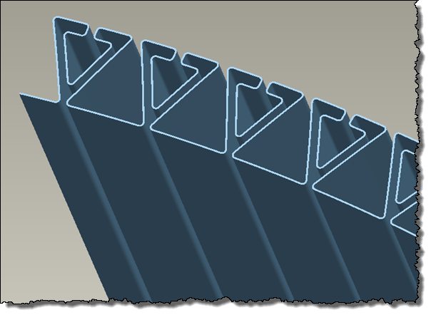

I agree...
Flatten Quilt can be finicky... but it's very powerful. I didn't try playing with the Parametrization Surface or Method but both can used to provide alternate results. Usually I use Flatten Quilt in conjunction with Solid Bend to achieve some cool "bent" effects like these. Both objects were bent using the Flatten Quilt/Solid Bend technique...
It's hard to see the curve in this next image... but it's there. You can do some pretty extreme bends using Flatten Quilt as the basis. There was no need for an extreme bend in the case of the object below...
