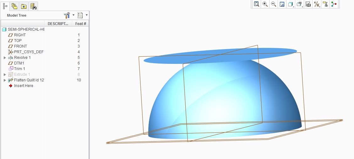

Hi there Guys,
I'm a industrial designer and new Creo Parametric 2.0 user. In fact, i'm testing CREO to implement it in the company I work for.
We are a Pressure Vessel Designer and Manufacturer so, most of our pruducts will need the feature I'm looking for.
I'm trying to flatten quilt a semi-spherical surface so I can define the size of the plate to be used in the manufacture of a Vessel Head. Obviously, The area of a Sphere suface is a known area, but I'm just using it as an exemple. Vessel head will have Semieliptical, torispherical, and some other forms with more than one radius and etc. Also I don't know if i'm using the correct feature. I was able to flatten and curved surface, but not a domed one. Can anyone help me?

In the real world you cannot flatten a domed part without significantly stretching the material (at the circumference), it is a non-developable surface. Likewise you cannot create a domed part from a flat piece of sheetmetal without stamping/deep-drawing it.
So, the end result is going to be a little funny if you try and flatten it. There was some work done here by sever people, Antonius the most prominent, dealing with doming a mesh, I'd search that thread.

April 17, 2014

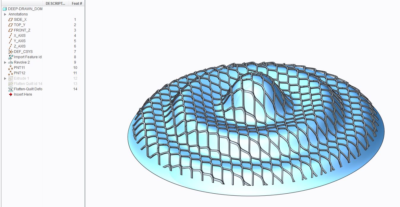

Placing the physics of the material aside, you can perform a "flatten-quilt" on domed geometry as opposed to a sheet metal "flat patten", if that's what you are trying to do. That being said, you cannot perform a flatten-quilt with your particular geometry due to the fact that the sides of the dome become normal to the flattening plane. If you trimmed it just past that point, it will work, see below. You could also cut the model in quarters and flatten to a plane that is at 45deg. You'll also need to do a manual parametrization because of the compound curvature. Given the limitations of this feature, you ultimately may not be able to create what you are intending to if you really need the vertical walls.
Just be aware that at this point you've crossed the boundries of reality and wandered into cartoon land. And, as David stated, the flatten-quilt is just a projection. So if you are fine with those aspects of it, you can create the flatten-quilt but it's real benefit comes from using it as a form to "cartoon" bend solid shapes, curves, etc. that may not be possible to model any other way.
The picture below is from the discussion (Solid "Deep Drawing" (how to?)) Frank mentioned. As you can see, reality has been breached. But it has its uses.
