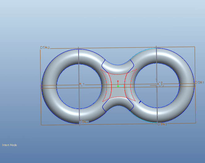

How to proceed from here,having trouble with surfacing.
  • June 11, 2014
  • 20 replies
  • 5021 views
Practising surfaces,can't seem to find solution from here,did i paint myself into a corner?
It should be something like this.
Here is the prt file

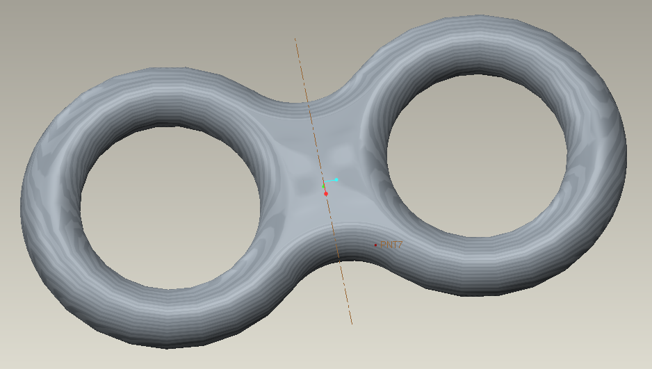

Best answer by MauroStefanovic
Here attached the best i can. Tangency and normal costraints everywhere.
Interested in how to get curvature continuity everywhere.

Oh, now that's a dangerous challenge
gkrishna1-VisitorAuthor
June 11, 2014
Problem is there has to be tangent surface connecting those 2 rings without that little collapse.
June 11, 2014

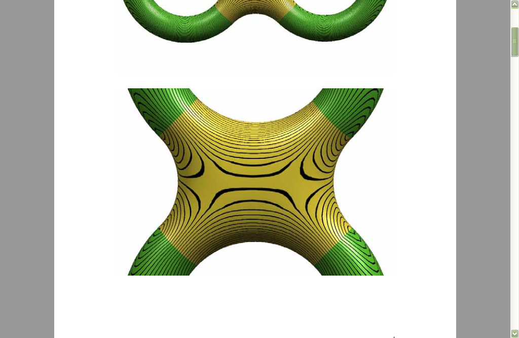

June 11, 2014
Here a screenshot

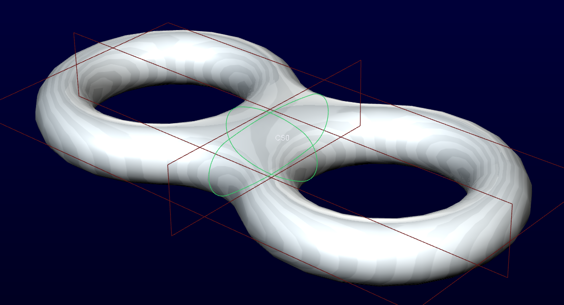

ptc-4684141 wrote:
It appears that the center is not flat. Like it somehow has to merge with an oval(ish) X and Y section.
Patriot_1776
June 11, 2014
Why surface it, it appears you can achieve this with solids.
Edit: I just did it with a solid and a rnd containing 3 sets of full rounds. 2 features. I'm assuming it's toroidial on the ends?
June 12, 2014
Here you go Frank... (Creo 2.0)
This is really a challenge without the advanced surface extension.
Indeed, 2 features will make the basic part. This one has a center "bulged".
Warp can do this too but not as controlled.
