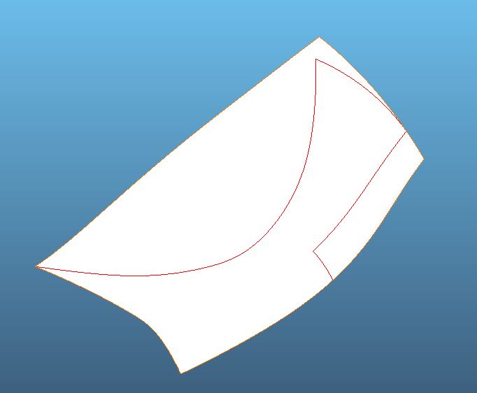

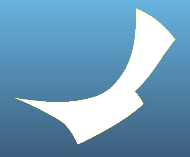

Hello Community,
i need to untrimm some surfaces. I try the extrapolate function in the import data doctor
and get a good preview of the untrimmed surface but i can not keep it.
Is there a trick to remove a trimcurve from a surface, maybe inside the step file?
I use Creo/Elements/Pro with ISDX.
Thx for any help,
Michael

Your first approach works as well BTW. Inside the IDD (Import Data Doctor), switch the selection filter to Edges, select one of the edges of the surface and hit delete... that's it.

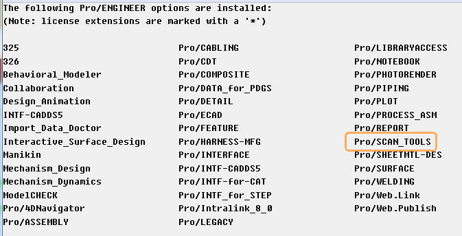

Hello Constantin,
your first tip did not work maybe you have another license for it?
But the second one was good and works fine for me.
Thx,
Michael
March 25, 2013
You are right, you need the Pro/SCAN_TOOLS licenseScantools_ic.jpg
