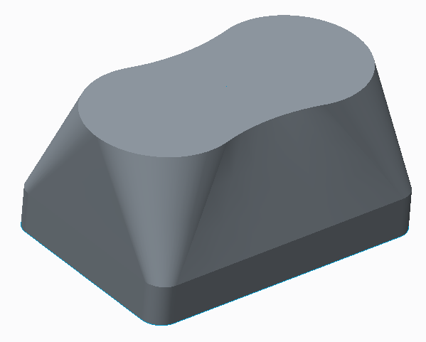

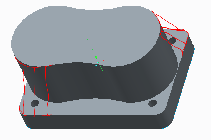

I've been trying to find a way to get the top rectangular edge to blend with the edge of the peanut shape,such that it appears trapezoidal. I'm creating a straight line that vertically intersects the middle of the peanut shape's top plane and the center of the rectangle's top plane. Then I use the project feature in the sketcher to to retrace the rectangle for the first sketch, then for the second sketch i do the same for the peanut shape. However, it won't generate the sweep and I can't figure out how.
Anyone?
Best answer by manjunathrv
Casey,
Is this what you are expecting?

Casey,
cmccarty1-VisitorAuthor
May 11, 2016
Yes, that's it!  How did you do??
May 11, 2016
I used swept blend- used your centre curve as main trajectory and the sketched 2 sections using your curves. In the second sketch you need to divide the curve to used as blend vertex.
I will send you the model soon.

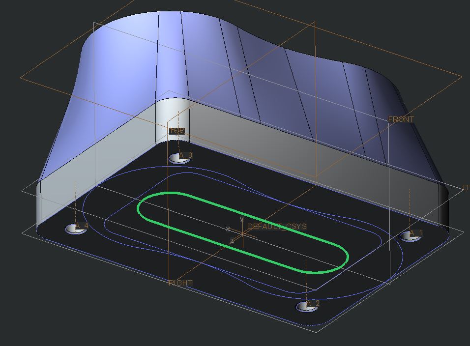

May 11, 2016
Hi, you could try an old school feature called Blend Section to Surface. You will have to search for it, as it is not readily available in the standard Creo toolbars.  See the attached model, it might yield satisfactory results.

May 12, 2016
I attach a similar model in Creo 2 so you can see the feature I describe.

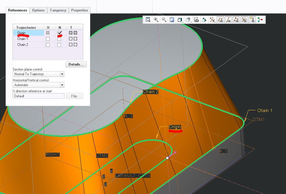

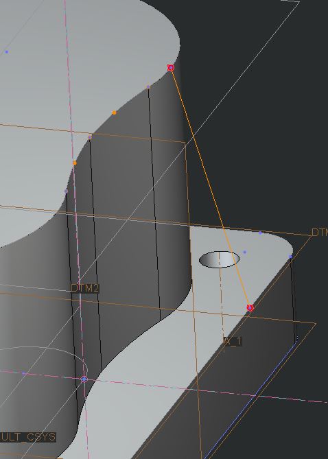

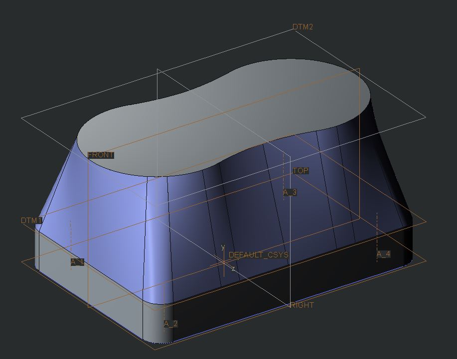

May 11, 2016
Here's another solution using a Variable Section Sweep.  I created another trajectory (on the bottom) to control the section normal.  It's a simple oval.  The section is a straight line between the two edges.
It produces a slightly different shape:

May 12, 2016
It's easiest for you to understand if you look at the model, but I'll give it a shot.
For a sweep, Creo needs to know how to position and orient the sketch as it travels along the trajectories.  You need to define the sketch plane normal and the rotation along the trajectory.
For the geometry you have, using either of the two trajectories as the normal  trajectory (sketch plane stays normal to it all along the sweep) creates problems with overlapping geometry,   By creating a third trajectory (a simple oval with the centers aligned with the centers of the peanut shape, see below) that only defines the normal of the sweep, I eliminated the overlapping geometry.
The section is then a straight line between the rectangular trajectory and the peanut trajectory.

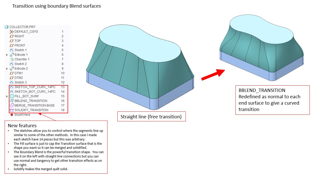

May 13, 2016
Hi Casey,
Another way is to use Boundary Blend surfaces.
e.g.
This allows a lot of control at the expense of a small amount of complexity.
Regards. Brent Drysdale
7-Bedrock
May 13, 2016
e.g.
