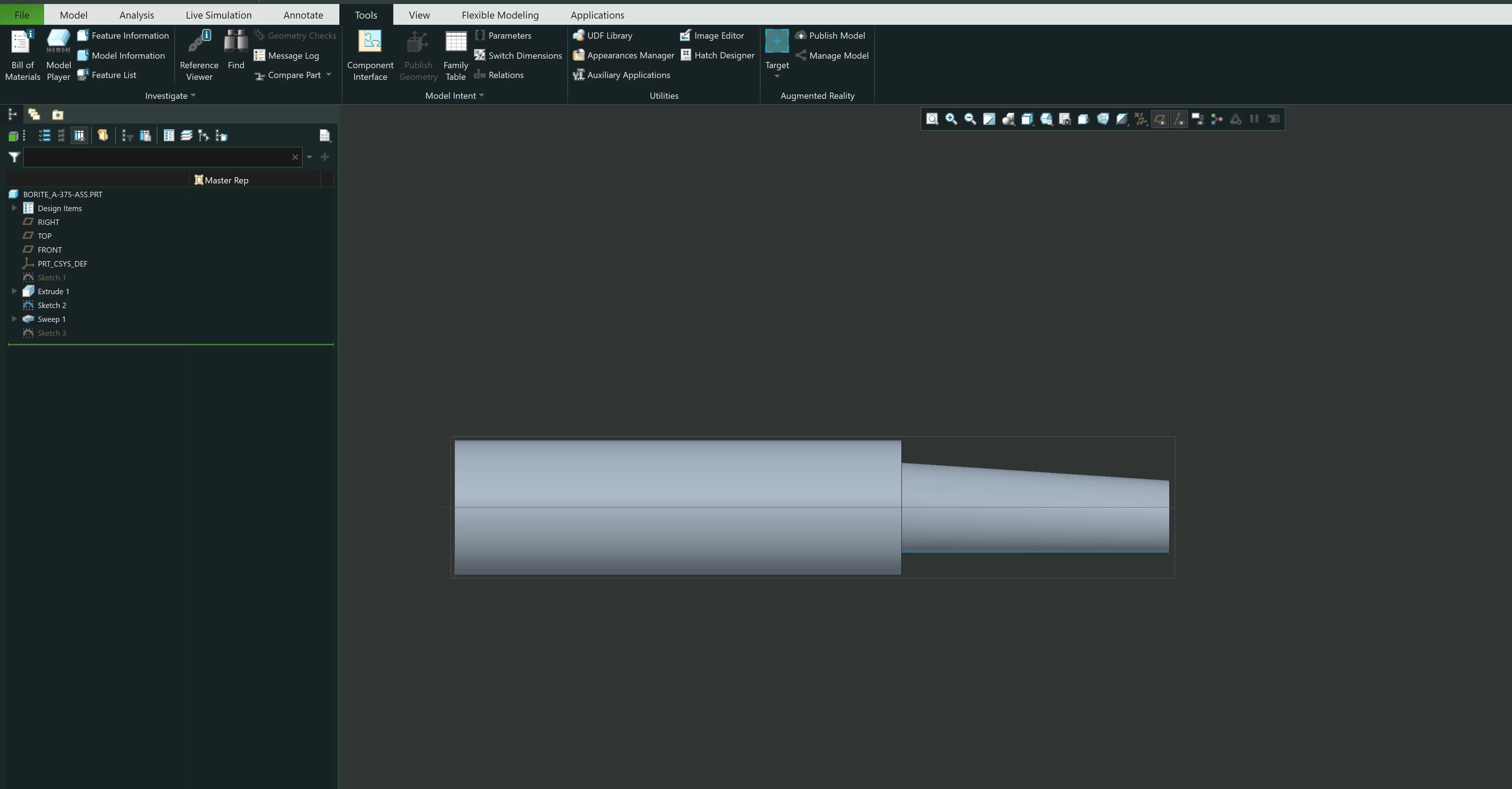

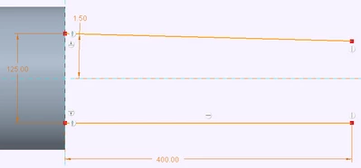

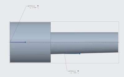

I am designing a piece and the shaft of it needs a 1.5 degree angle on it
I am designing a piece and the shaft of it needs a 1.5 degree angle on in while keeping one side straight and I've done what I know but I was wondering if there was a different way I could actually use the angle instead of what I've got in the pictures. Or if there's any easier way to do this I would appreciate any help I can get thanks.
I am on Creo Version 9.0.1.0

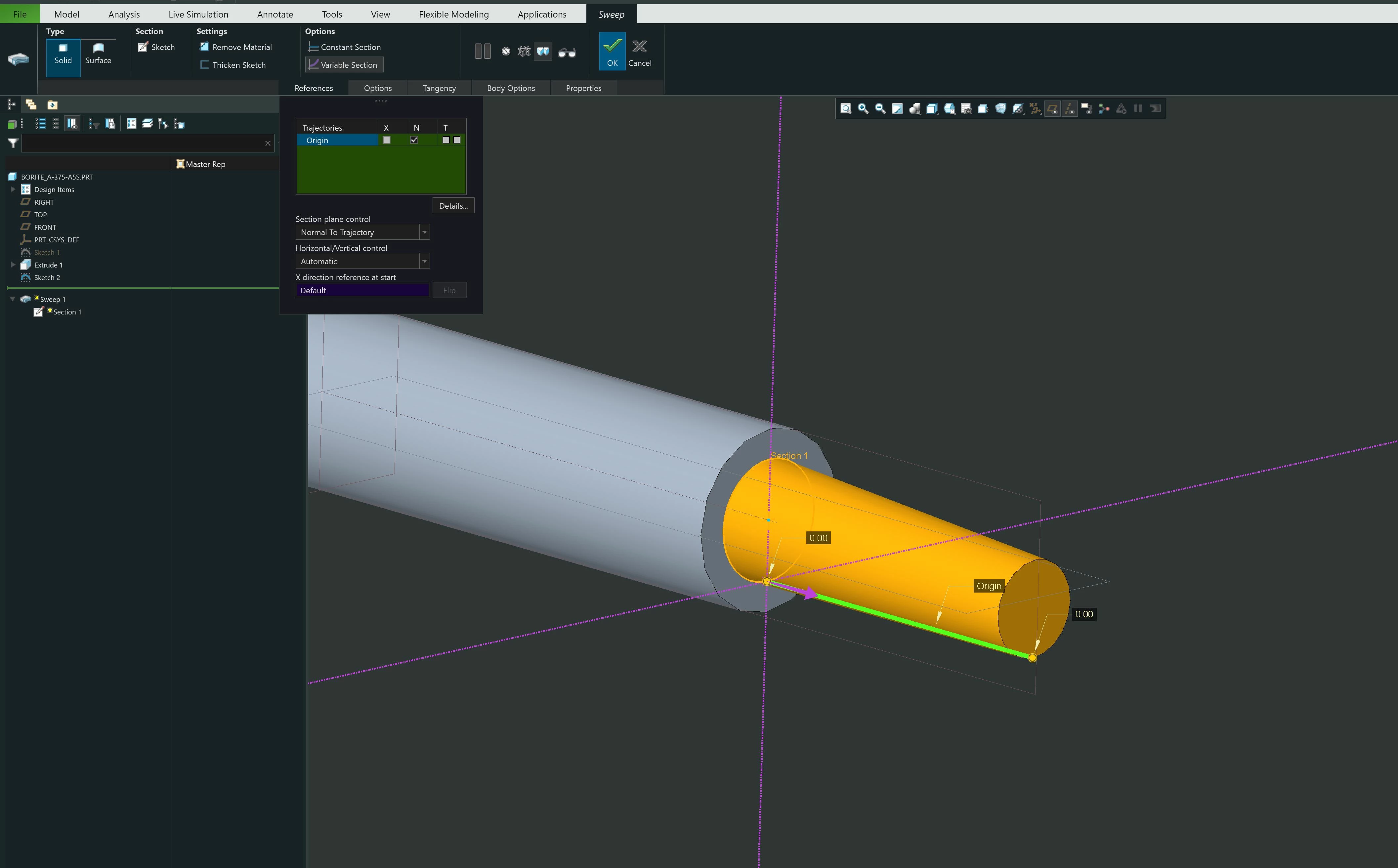

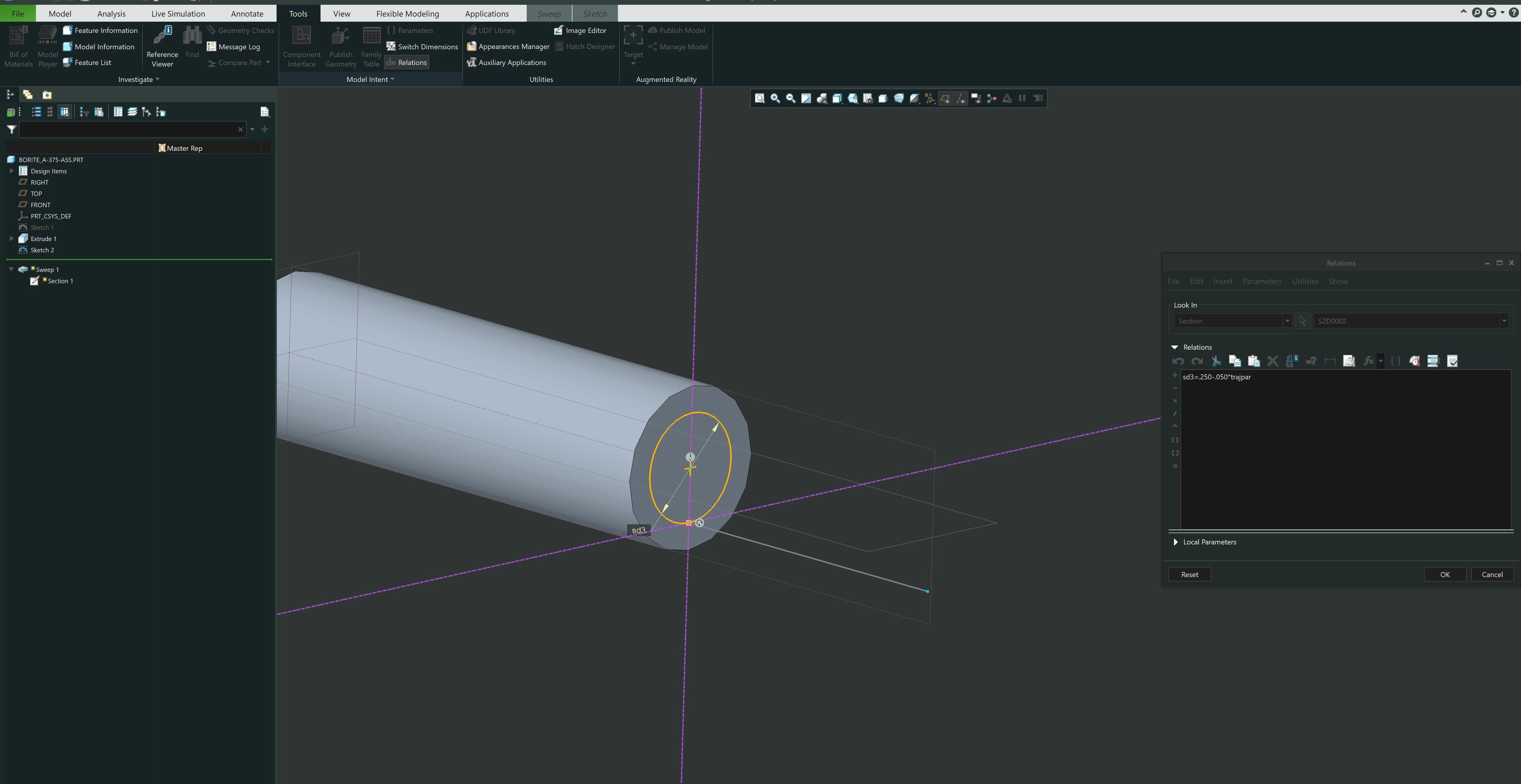

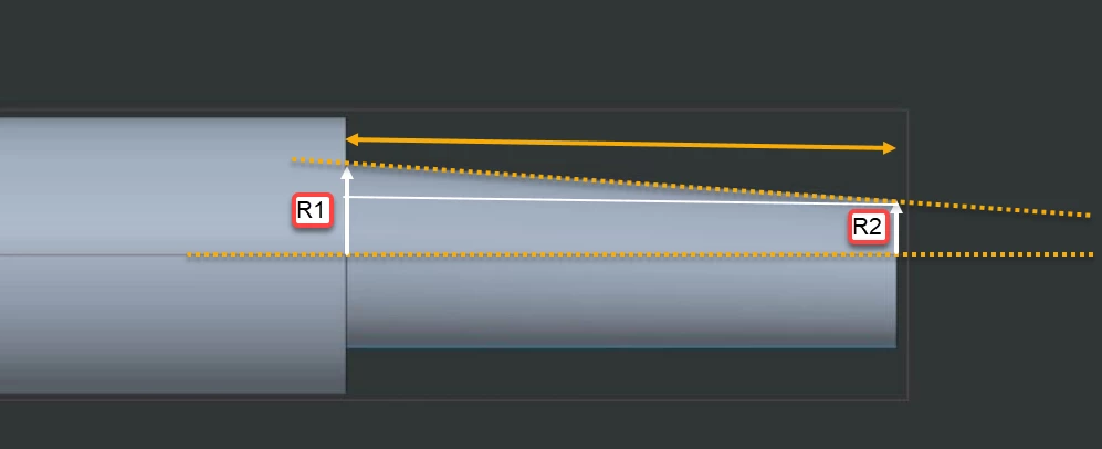

Using the variable section sweep is a good way to model this IMO. It is efficient; using one feature to define the geometry. You may want to consider using part relations to drive the VSS sketch relations in trajpar as a function of the desired angle. This would support the designer setting the angle directly and using some trigonometry to derive the trajpar sketch relations.
3-Newcomer
May 20, 2024 2:30 PM UTC
so is there a way to use an angle instead of two different diameters in the part relations
tbraxton
May 20, 2024 2:53 PM UTC
I am making the assumption that you know the diameter at the start of the taper and the length of the taper in addition to the angle of the taper. If this is not the case, then describe what inputs you want to use to drive the design.
You have a right triangle when viewing the section along the taper from the proximal to distal end. Assuming you know the diameters of the taper at the proximal end, the length of the taper, and the desired angle before creating the VSS feature then you can use trigonometry to calculate what R2 (@ distal end) must be and use these values by passing them to the VSS feature sketch relations from the part relations.
You can see below that you can use a right triangle to solve for the values needed to drive the VSS sketcher relations.

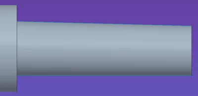

A swept blend may be a good option depending on the design intent.
Create a sketch to define the path:
I used the horizontal line as the trajectory and the angled line to set the diameter.
kdirth
May 20, 2024 3:50 PM UTC
Creo 7.0 attached.

May 22, 2024 7:51 AM UTC

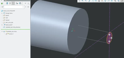

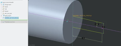

I'm thinking to construct a side-sketch that specifies the protrusion's length, diameter(s) / taper angle:

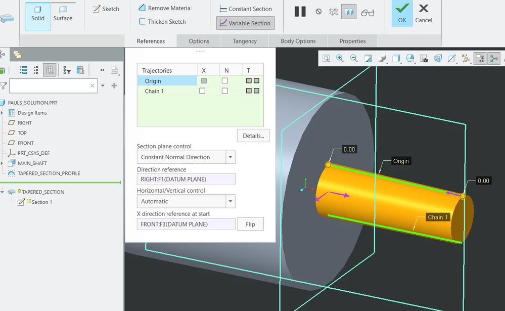

Then use that sketch curves as the basis of a 2-rail variable section sweep:
Note: add the 2nd rail (chain 1) by holding ctrl + clicking
The cross-section is a circle that needs to touch the 2 rails:
