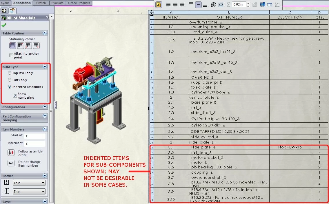

Hello Everyone,
I am unable to create indented BOM in same as like Solidworks drawing (I have attached a Image). Please anyone suggest me, how can I get over this problem.
I am able to place indented (Sub-Assembly parts) in BOM but its getting continuous Index numbering 1, 2, 3....
I need Index numbers as follows
1,
1.1,
1.2,
2,
3,
3.1,
3.2 ...
