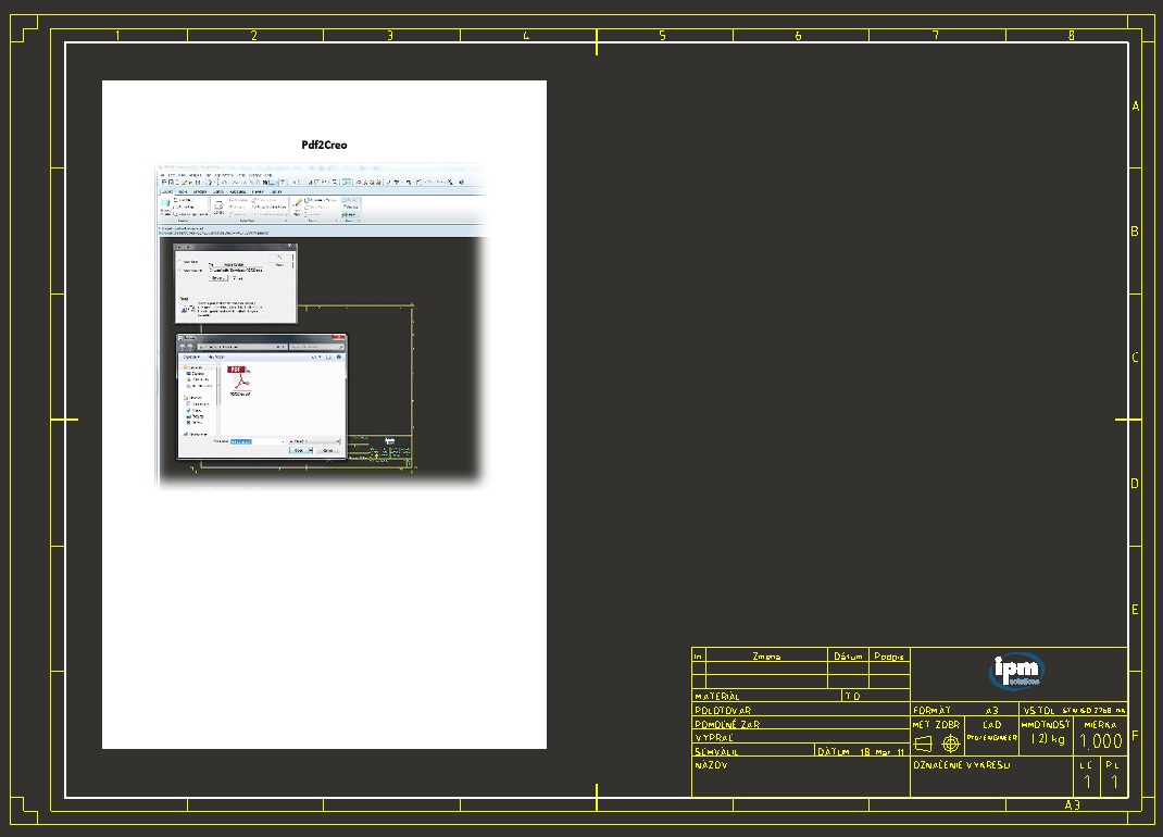

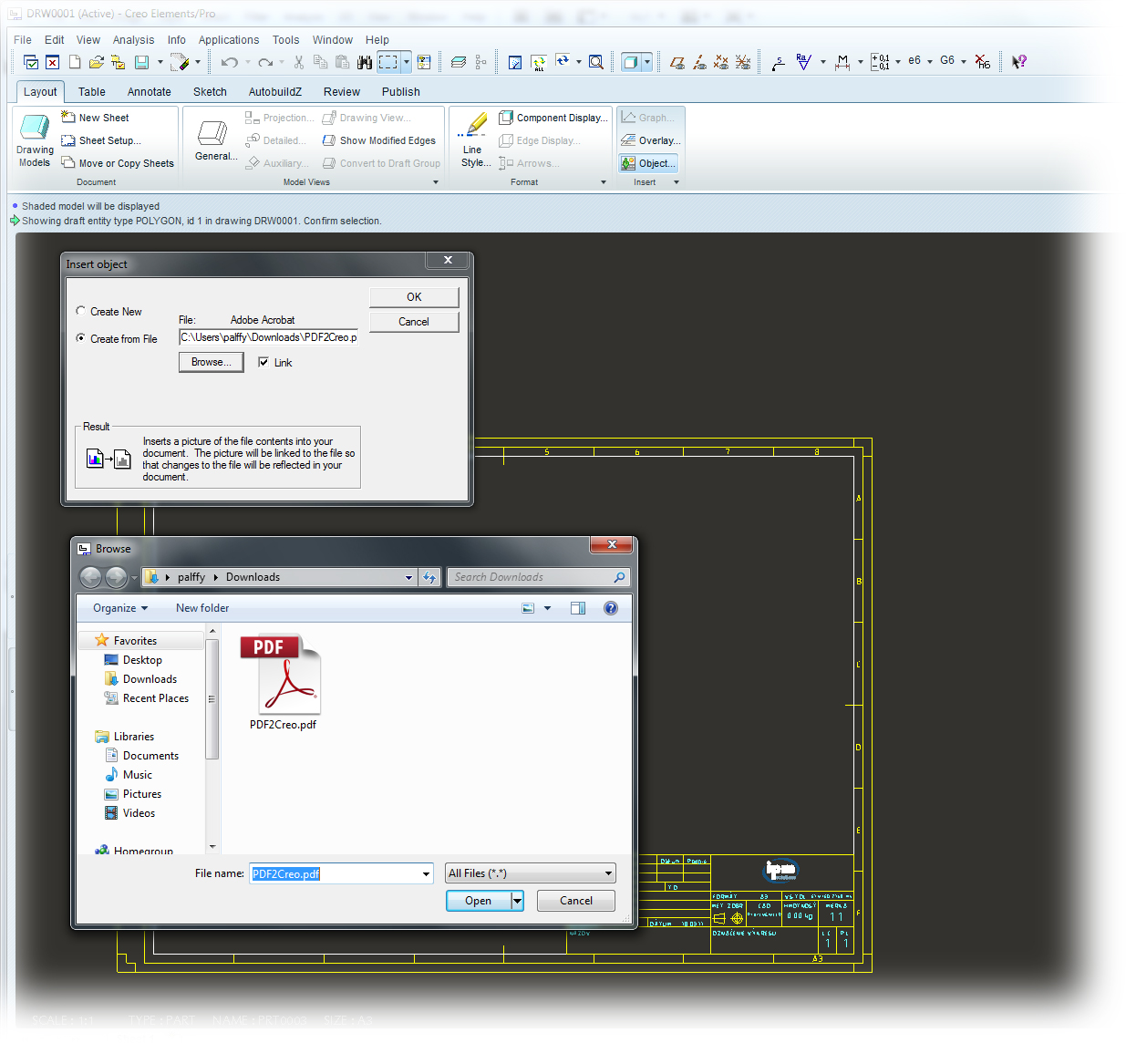

Hello Deddy
If you need embed a pdf file to Creo E/Pro 5.0 drawing click in the Rbbon menu > Layaut > Object... >> Create from file >> Browse and the select your pdf file > Open
For example:
Embeded pdf file in Creo Elements/Pro (formerly Pro/ENGINEER)
