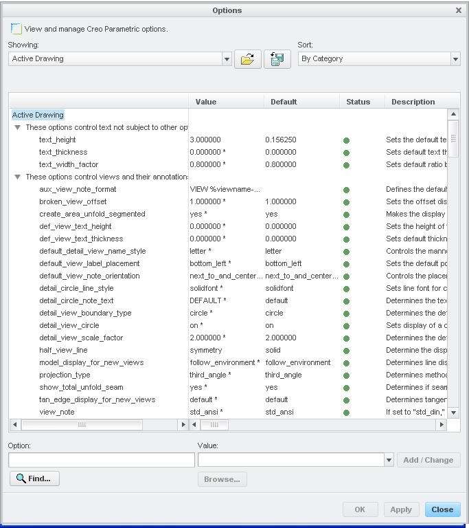

Since I bought Pro/E Wildfire 4 four years ago, I have still not made it working completely with the metric system. I.e when I am creating a drawing my texts are really small and a lot of other problems.
Why is it that hard to find a standard setup for the ISO system including line thickness and text sizes.
Anyone can help me?
At the moment I am using Creo 1 and it is the same problem.
The swedish PLATINUM PARTNER ECONOCAP can't after about four years of service contract.
When I used Inventor before it was really easy. Maybe it is time to change back???
Thanks in advance.

Hi
Pro-e gives more flexibility than other softwares (Related to configuration)
For example
Font size in drawing can be easily changed in Drawing option(.dtl file)
After you change your font size save the configuration at specific location
Give the path of the file in your config.pro
To go to drawing options
Go to
File>Prepare>Drawing Properties
Details options(Click Change)
Then change your font size in the following
Text_height
If it resolves your current problem; you can post your rest of the problems.

You may use my confıg fıles ıf ıt helps. You may have to edıt some of the settıngs for your own use. The settıngs are for WF5. Hence you are requested to compare the settıngs One-BY-One before usıng ıt as ıt ıs. It ıs possıble some of the settıngs have changed ın Creo.
ConfIg.pro
ConfIg.dtl

A note of caution: The files would have my own folder mapping. Hence I would recommend that the config file is not used as it is but compared side by side with your existing config files. A method could be importing the two into Excel and compare using the VLOOKUP.
November 12, 2012
In proe all you need to set up one .dtl file for metric system and it will work good. By using config.pro font_dir option you can also set windows fonts into proe drawing. Make one metric setup file and use it repeatitvely.
