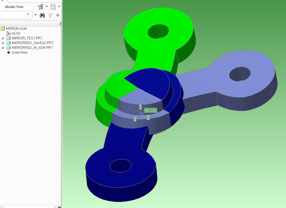

I have a part model that I need the opposite hand for. The most obvious way of creating this mirror model would be to go FILE/SAVE AS/MIRROR. The only problem is that you can NOT choose the plane to mirror from. WHY NOT? There is absolutely no reason this crucial step shouldn't be included.
There is a work around that involves extra un-needed steps.
This includes going into an Assembly and creating the mirror from this. Within Assembly it does allow you to specify the mirror plane.

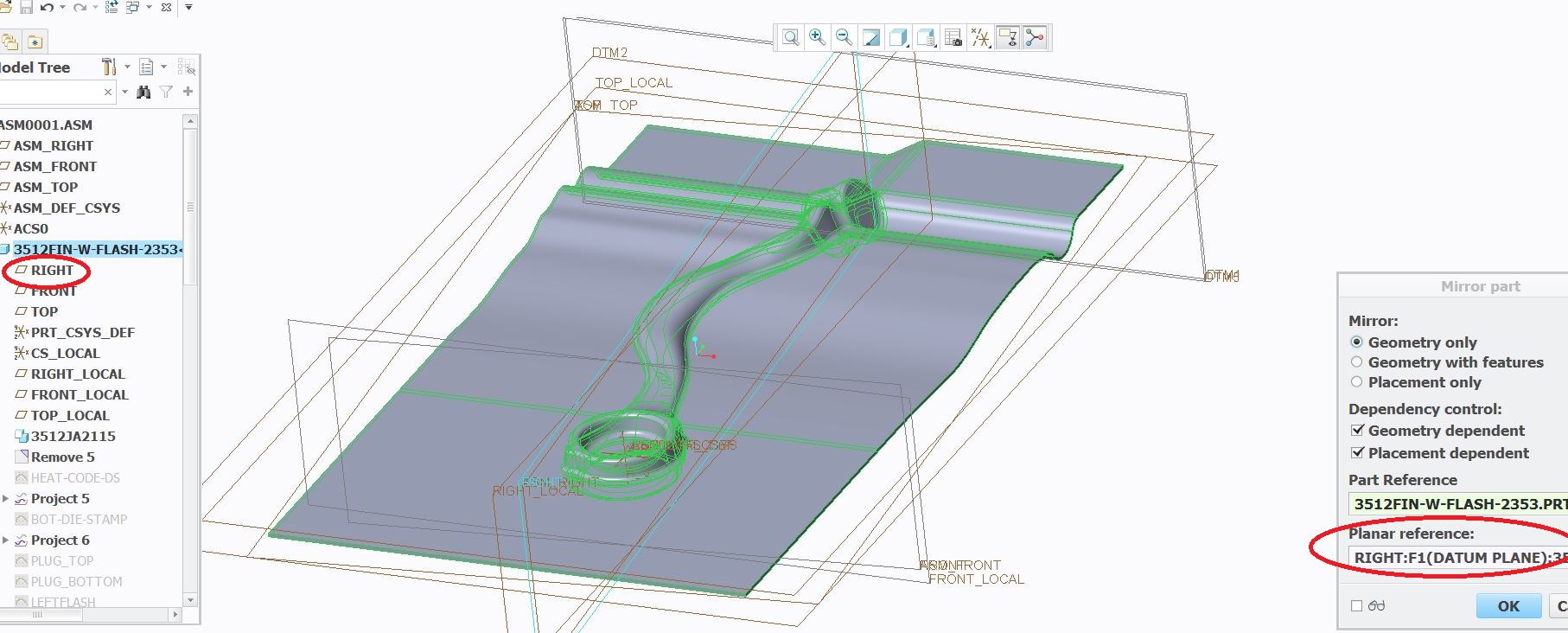

I have followed PTC's specific directions to produce my needed mirrored part.
I specified the mirror plane from my original part (I also tried this with the Assembly mirror plane)
I am very happy with my result. See picture below (New mirror is in green)
The satisfaction fades however as I see that my model is precisely the way it mirrored before. See picture below.

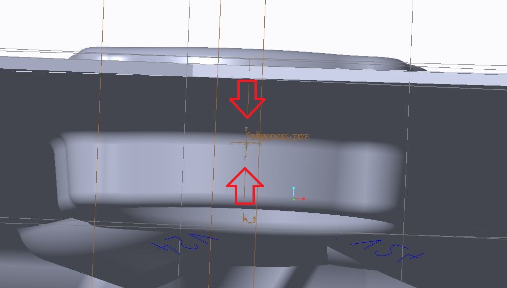

After the ensuing frustration I discovered that I could rotate my part so I was able to get the correct orientation. See picture below.
When I go back into Assembly after rotating the part I see that it displays incorrect to the view visibility within the part. See below picture
Any idea as to why my Part and Assembly models do not line up?

The mirror operator flips the coordinate values relative to some plane. I don't know what plane part-mirror defaults to (probably X-Y, so plus-Z becomes negative-Z) but I guess the default isn't what you want. In the assembly you picked a different plane, and it mirrored like you wanted by using the same mirror as the part plus a rotation/offset to move the mirrored part to the desired location. If you go into that part and add more rotation, that rotation will be seen in the assembly.
I think I understand why you don't like the way it works, but there is no switch or command or any method that makes it work differently. I would probably create a new coordinate system in the mirrored part that was in the orientation and location I wanted.

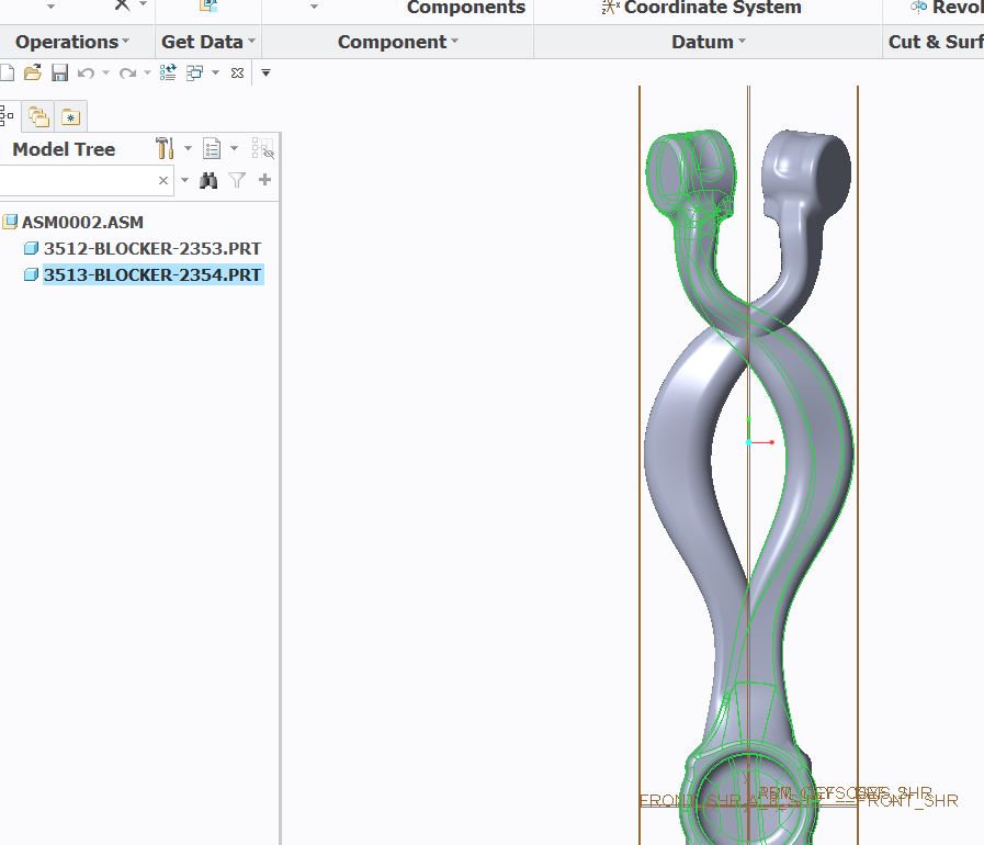

Just out of curiosity, you said you went back to the ASM0002 assembly after modifying the 2513-BLOCKER-2354.PRT, and noticed that the mirror part is not oriented correctly. Did you also notice that this modified part is placed in the assembly using "Fix" constraint? If that's true, what happens if you change that "fix" constraint to "Default"?
By the way, how did you rotate the geometry of the 2513-BLOCKER-2354.PRT - that is, how did you create the "Moved Geometry 1" feature (I was trying to use flexible modeling, but it's not easy to precisely control the result!)

This is what I did and see if i understand what is happening to you. By the way, I wholeheartedly agree with you that the Creo mirror functionality has the serious limitation in that it always mirrors about the "internal" x-y plane.
Shown in the image is an assembly of three components each constrained by "default".
Starting with the light blue part: if you do a save-as mirror function to that part you will end up with the dark blue part. Note that the mirror plane is the x-y plane of the default coordinate system.
Now, suppose what you actually want is the light green part - one that's been mirrored about they y-z plane. Well, if you use the assembly method of mirroring and create the mirror component (green - MIRRORED_IN_ASM) using the x-y plane of the light blue component, you will get what you see above, which looks great except as you mentioned, the green component is actually identical to the dark blue one. Creo merely does the same "x-y" mirror and then applied the "Fix constraint" to position the new part in the right location - in this assembly. In other words, if you change the "fix" constraint to "default", the green part will end up overlapping the dark-blue one.
So to get it to the right position, I transformed the geometry of the light green component by rotating it about its y-axis by 180 degrees. This modified component is now shown in the "default" orientation and is the correct mirror of the light-blue original. Also its views are preserved, etc...
I'm attaching my test files if you want to examine this. I know that this is a simple example and the corrective transformations can be much more complicated than a simple rotate about y-axis by 180 degrees, but that's how it is. The only other thing to keep in mind is to model your "to be mirrored" parts knowing that they will be flipped about the default x-y plane.

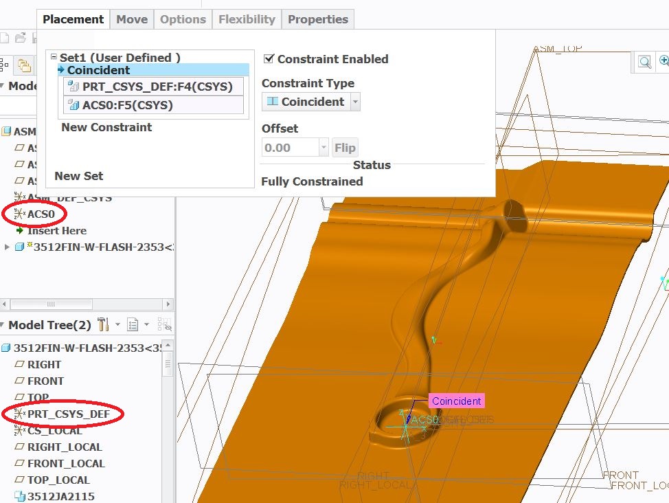

1st of all I placed the ASCO CSYS in the assembly. The placement of this didn't seem to influence the result. Whether the ASCO was rotated 180 or placed straight up the result I received was the same.
I inserted the component that I needed mirrored using the Coincident constraint. For the component I used the PRT_CSYS_DEF. For the Assembly I used the ASCO which I created.
Next I set up the Mirror operation. This was done using the Create Component command. I used the mirror part option. I part referenced the inserted component. I planar referenced the RIGHT datum which I needed the mirror completed off of.

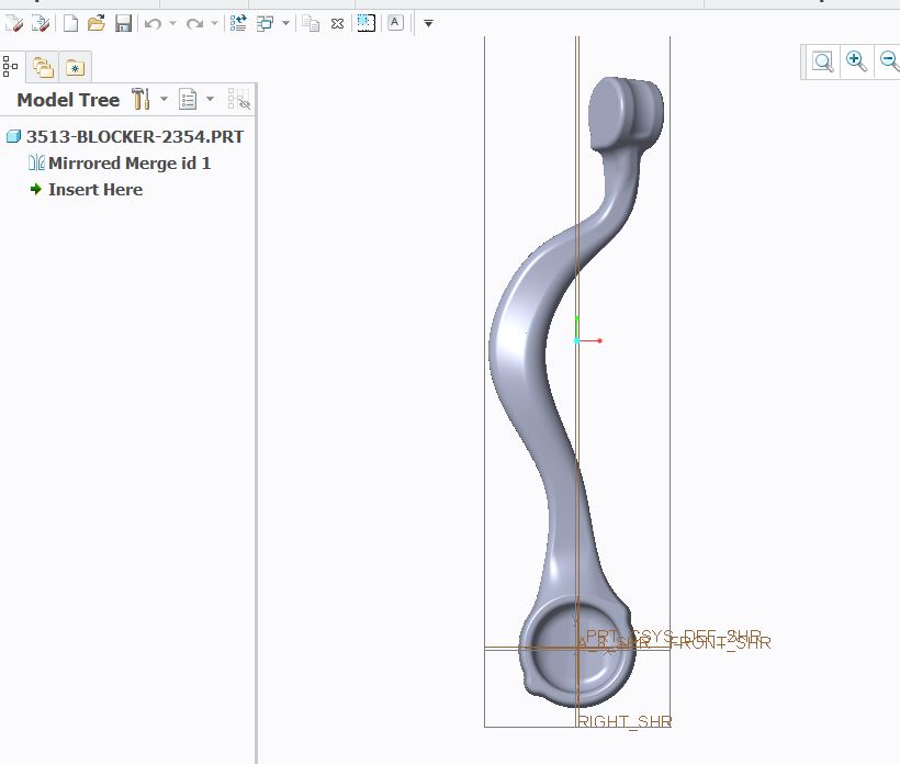

This mirrored the part. On 1st inspection the mirror looks correct. Unfortunately when you zoom into the CSYS area you see that the new part has a flipped Z orientation as shown.
This unfortunately means that the part that you Open has the views flipped. When you bring this part into another model such as Pro Mold you see that it is rotated 180 degrees out of position.

Check again how the mirrored component is placed in the assembly. I'm suspecting it is using the "Fix" constraint.
Go edit the mirrored part and add to it a new CSYS, using the default PRT_CSYS_DEF as the reference.
This new CSYS will be transformed by rotating about some axis of PRT_CSYS_DEF by 180 degrees (I'm not sure which, try Y-axis).
Then go back to the assembly and redefine the placement of the mirrored part: use the coincident constraint between ACS0 and the new CSYS you just made.
This will position your mirrored part correctly in the assembly. In the same manner, you have to bring in the mirrored part into Pro Mold using the transformed CSYS...
And yes, unfortunately the views in your mirrored part will be flipped around.
The alternative is to move the mirrored geometry around to locate it correctly relative to the part's default csys.
